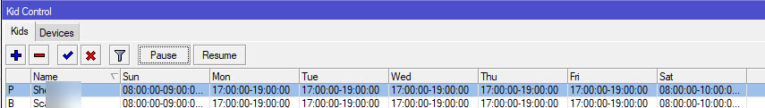

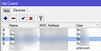

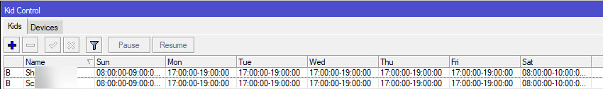

Anyone else experiencing where you cannot bypass kid control with the pause button? What I am finding is that when I press “Pause” the Kid is “paused” but is does not stop from blocking the devices assigned to that child. I have to then go in and disable the blocking on every mac address that the child should be able to use.
Also, I see the FW rules dynamically added to block these devices. When pausing a kid, this blocking rules are not removed, but when I disable a device on the Devices Tab, the rule is removed. Not sure where to go from here.
