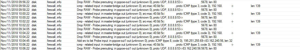

An other strange thing is that displayed log looks different in the sequence of the events;
Nov/11/2018 09:56:22 firewall,info icmp - related input: in:master-bridge out:(unknown 0), src-mac 40:8d:5c:b2:fa:ed, proto ICMP (type 3, code 3), 192.168.xxx.xxx->192.168.xxx.xxx, len 139
Nov/11/2018 09:56:22 firewall,info Drop RAW - Probe prerouting: in:pppoe-out1 out:(unknown 0), proto UDP, 8.8.8.8:53->wan.wan.wan.wan:5678, len 80
Nov/11/2018 09:58:22 firewall,info icmp - related input: in:master-bridge out:(unknown 0), src-mac 40:8d:5c:b2:fa:ed, proto ICMP (type 3, code 3), 192.168.xxx.xxx->192.168.xxx.xxx, len 139
Nov/11/2018 09:58:22 firewall,info Drop RAW - Probe prerouting: in:pppoe-out1 out:(unknown 0), proto UDP, 8.8.8.8:53->wan.wan.wan.wan:5678, len 80
Nov/11/2018 10:00:22 firewall,info icmp - related input: in:master-bridge out:(unknown 0), src-mac 40:8d:5c:b2:fa:ed, proto ICMP (type 3, code 3), 192.168.xxx.xxx->192.168.xxx.xxx, len 139
Nov/11/2018 10:00:22 firewall,info Drop RAW - Probe prerouting: in:pppoe-out1 out:(unknown 0), proto UDP, 8.8.8.8:53->wan.wan.wan.wan:5678, len 80
Nov/11/2018 10:02:22 firewall,info icmp - related input: in:master-bridge out:(unknown 0), src-mac 40:8d:5c:b2:fa:ed, proto ICMP (type 3, code 3), 192.168.xxx.xxx->192.168.xxx.xxx, len 139
Nov/11/2018 10:02:22 firewall,info Drop RAW - Probe prerouting: in:pppoe-out1 out:(unknown 0), proto UDP, 8.8.8.8:53->wan.wan.wan.wan:5678, len 80
Nov/11/2018 10:04:22 firewall,info icmp - related input: in:master-bridge out:(unknown 0), src-mac 40:8d:5c:b2:fa:ed, proto ICMP (type 3, code 3), 192.168.xxx.xxx->192.168.xxx.xxx, len 139
Nov/11/2018 10:04:22 firewall,info Drop RAW - Probe prerouting: in:pppoe-out1 out:(unknown 0), proto UDP, 8.8.8.8:53->wan.wan.wan.wan:5678, len 80
I see the show log a misplaced 09:34:05 timestamp between 10:02:22 and 10:04:22 of two minutes DNS request for the Cloud I don’t use.
