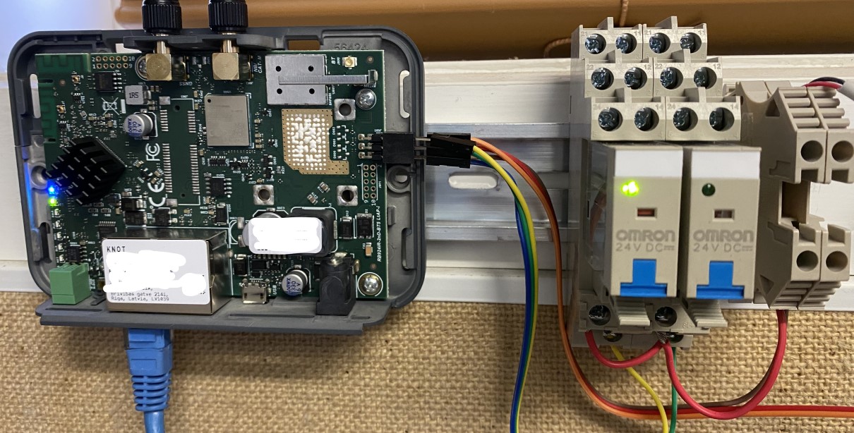

With 5 minutes on hand I have setup a quick example application for a KNOT with DC Relay’s attached to work as an access control system using Bluetooth Dongles w/button.

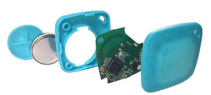

The dongle is a generic one from Ali Express with button push feature.
The objective was to be able to toggle the relay with a push of the Dongle Button - purely for fun although there will be some serious use for this down the line…
The dongle has a unique MAC address on the back and this is entered into the KNOT so it is aware of the dongle:not Config:

Next I had to identify the data coming from the dongle and see what changed when I pushed the button…
/iot bluetooth scanner advertisement print
In my case both devices sent data ending in 640000 which changed to 640001 when the button was pushed. Other devices may behave differently.
The relay was connected to the GPIO pin4 and was an OMRON DC24V relay. Note Mikroitk KNOT switches to ground so apply +24V to the relay and then the negative of the relay to pin4 and power negative to GPIO pin 1. +(DC)----relay—GPIO4-----Gnd (- DC).

I built the same circuit for testing and was happy that the outputs could be driven from the MK Knot… until I turned off the power to the Knot. The outputs are no longer controlled. They pass current and the relays turn on. Only after the system is fully loaded, the outputs are inactive. In practice, these outputs are uncontrollable and unusable.
