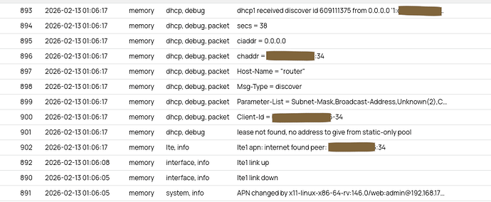

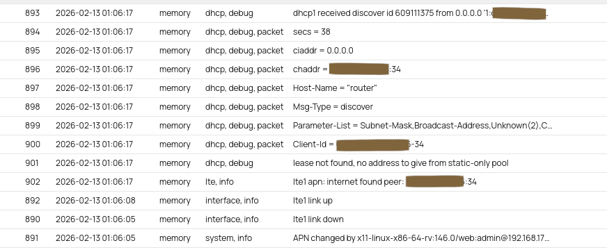

However, if the LTE link goes down for any reason, even just disabling/enabling the interface manually, then the DHCP server will never assign an IP again.
Logs still show “found peer” and the correct MAC address, but the DHCP debug logs say “lease not found, no address to give from static pool”.

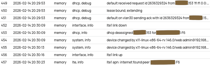

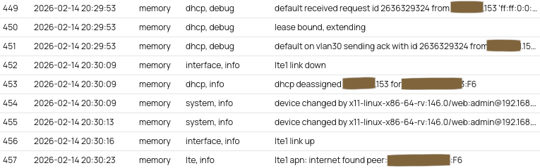

Here’s an example of me updating APN config, the resulting LTE link down/up, and DHCP failure (message sequence is bottom to top):
The vlan interface does get an IP, and the IP/subnet shows up in DHCP Servers→Networks, so it does not seem to be a problem with the LTE interface/APN config.

Here, things are working properly and the DHCP server extends the lease from the client, then I disable and enable the LTE interface, the link goes up and it finds the peer when it sends another DHCP request, but there is no DHCP server running (“IP→DHCP Server” is now empty) and no reply.
(this time I didn’t add the DHCP server explicitly, if I do, you see the behavior as in the first post, that there is no lease available, I’m guessing because RouterOS didn’t add the static lease when the peer is found)
