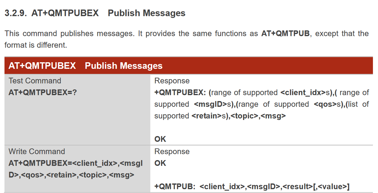

So I’ve found another documentation for Quectel BG95 & BG77 & BG600L Series and there’s a second type of command for MQTT Publish: AT+QMTPUBEX which allows to send message as a part of a command.
I’ll leave it here, in case someone has a same “problem” in the future :slight_smile:
