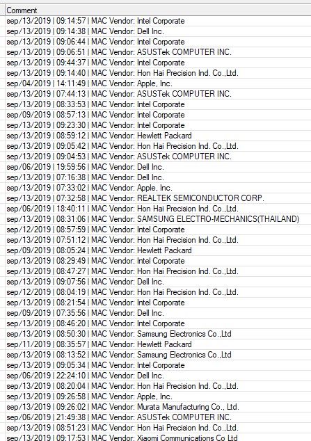

Then I recomend to use this dhcp Lease Script:
if ($leaseBound =1) do={
  local result ([/tool fetch url=("https://api.macvendors.com/".$leaseActMAC) output=user as-value ])
  if ($result->"status" = "finished") do={
    local comment0 ([/system clock get date]." | ".[/system clock get time]." | "."MAC Vendor: ".$result->"data")
    ip dhcp-server lease set [find mac-address=$leaseActMAC dynamic=yes] comment=$comment0
And DHCP Server Lease have got additional info in comment like
| Time & Date when they first time receive IP address. | Mac Address Vendor |
This is helpfully me detect connected not-autorized by me devices like TP-Links who have extend wifi in branch; select all VoIP phone or switches or cctv who are in bad vlan etc.
