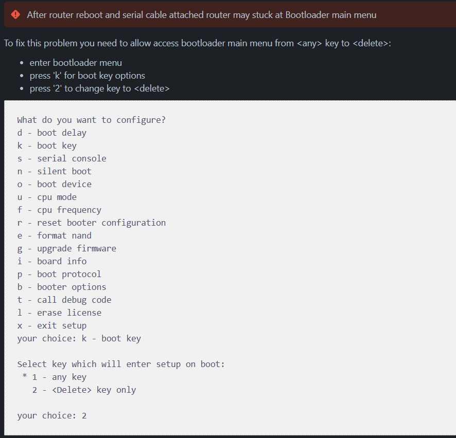

L009UiGS, RouterOS and RouterBOOT 7.20.6
exactly the same problem, eth1 LED off, eth2-8 LED is on, no connection
It looks like router stuck at Bootloader menu, but there is no serial cable connected
same problem here.
