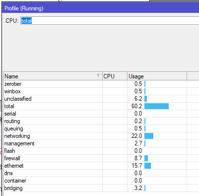

During speedtest tops at 70% cpu, see profile.
L009 has 2 cores at 800MHz while hAP ax2 has 4 cores at 867MHz. Both CPUs might be of different ARM varieties, but the stated difference does indicate that hAP ax2 is more potent device than L009. And official test results indicate that hAP ax2 is roughly 3-times faster router than L009.
I’ve no idea whether the above explains your experience or not, but mangling does exclude fasttracking which imensely improves IPv4 routing performance.
Yes, I noticed. I should have bought the RB5009 I think.
