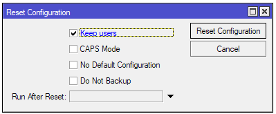

You can go to the menu System -> Reset Configuration and keep the options like this:
the click on the "Reset Configuration" button, and after the reboot it will revert back to the "basic plug and play" configuration that you saw when you first bought the router.
Personally, in such a situation I also tick "Do Not Backup" (no need to keep backup for a non-working config).
