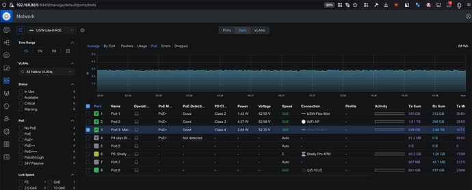

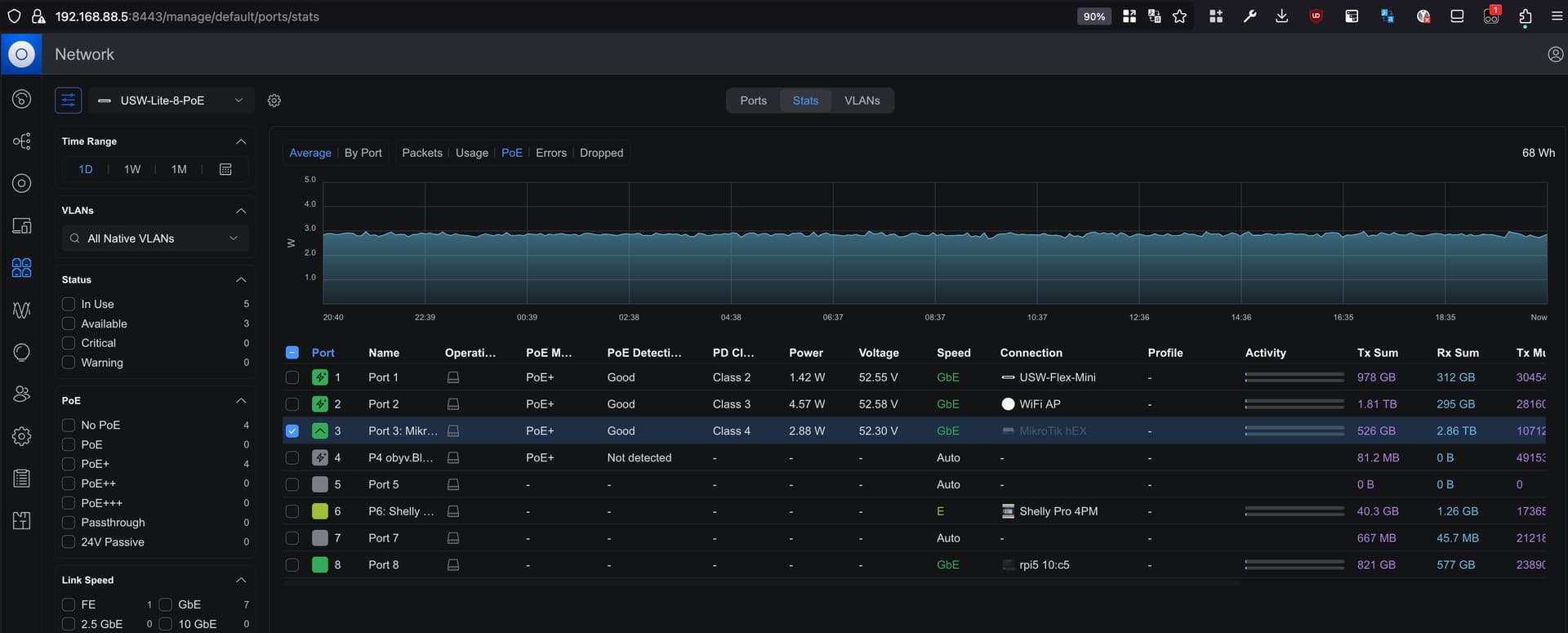

My current router is RB750Gr3 or hEX and it draws only 2,8~2,9 W :high_voltage: (including also DC-DC PoE convertor to 12V as shown in the image below)
  • according to my PoE switch which is providing power for MikroTik:
│   Unifi PoE switch      │
│   USW-Lite-8-POE        │
│ 2,8W                    │
   │52V
   │  │PoE adapter│
   └─►│ to 12V    ┼─┐
                    │12V
                    │ │  router       │
                    └─►  MikroTik hEX │
