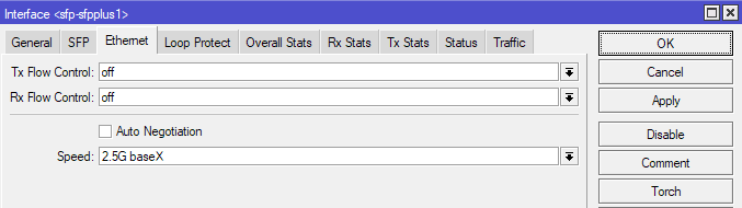

I am having a similar issue after I moved and switched over to the G-010S-A, although not as frequent as OP. I am using the G-010S-A with a RB5009 on Bell.
Additionally, if I set auto-negotiation it will not negotiate to 2.5G but if I set it manually, it is fine.
I did not have this issue before I moved when I was using the Huawei SFP.

I had the same issue but only if 10G was advertised. If I remove 10G from my advertised speeds, I immediately get an IP – but I only sync at 1G, not 2.5G which I would expect for my 1.5G plan.
I will experiment some more this evening with different link speeds and auto-negotiation selections and see what is stable.
I have been using a G-010S-P from ALCATELLUCENT (should be similar enough to your G-010S-A) since a couple of years with my RB5009 without any problem. You should try to turn off Auto-Negotiation and set the Speed to 2.5G baseX explicitly.
However, I do put head sinks on the G-010S-P and there is active airflow going around my RB5009, otherwise the G-010S-P would be very hot! The previous issues with your L009 might be heat-related.
Certainly not heat related. I was at around 50 degrees I believe.
