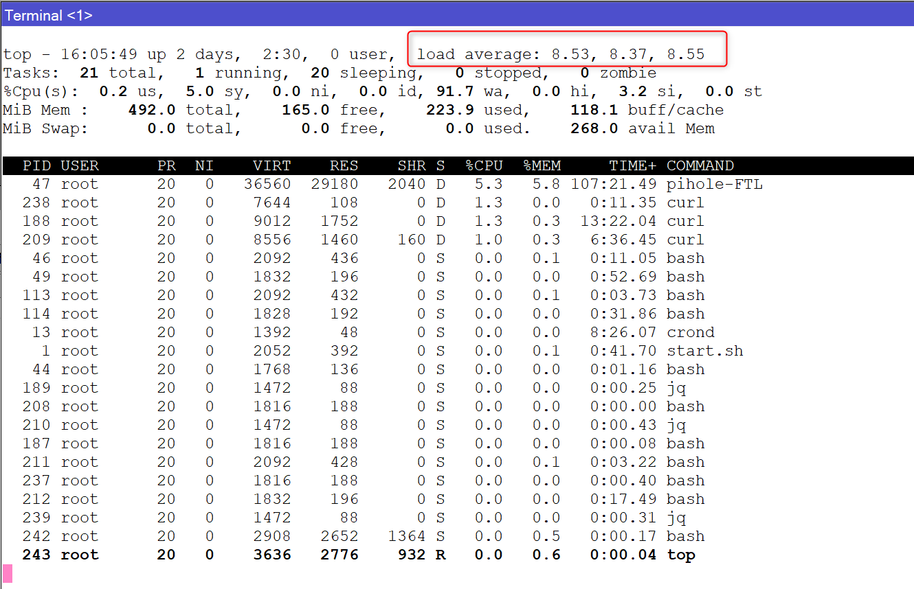

Running for 2 days only and it’s in a very very light use only 1 laptop is using it now. No problem with the RAM, but look at the CPU load. It’s already unreachable and timing out.

I obviously don’t know what’s wrong, but…
your “top” output doesn’t show high CPU usage (at only 5% of a single core), but it does show high load. Time a process spends in processing or waiting to do so contribute to the load, but so do things in iowait. This latter is what is the problem.
I wonder if the container is starting to run out of memory and swapping.

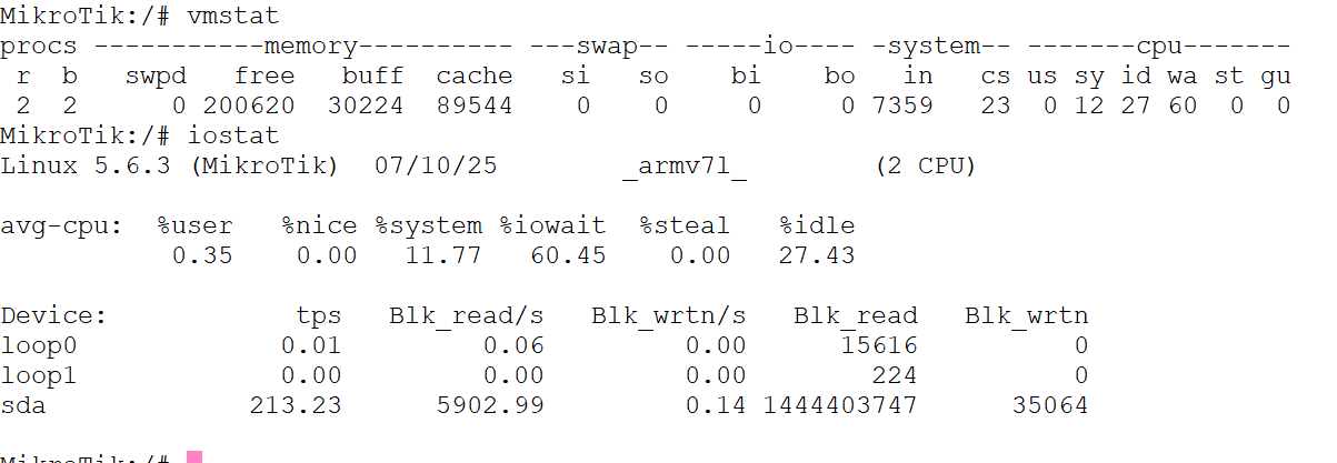

edit: from top output this doesnt seem to be swapping. Is it too much to hope for “vmstat”?
An iostat wouldn’t hurt…

just my two cents… look at the iowait, it’s too high, It seems your flash drive is the cause of the slowdowns.
