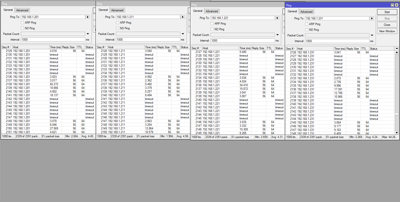

Have a small network using L22UGS-5HaxD2HaxD and 4 x SXTsq-5axD as stations, so only 5GHz enabled.
All stations are within 350meters from the AP with clear line of sight.
Average of -61db signal
Tx Rate=450-500Mbps
Rx Rate=200-300Mbps
At random times, all communication is dropped to all 4 stations at the same time, this lasts for 6 Pings each time:
This sometimes happens once in a few hours, or a few times within the same minute.
