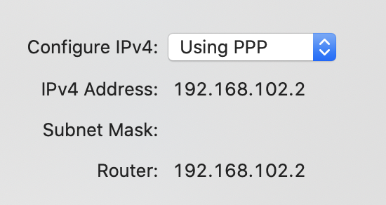

Is the client device configured to use the vpn as default gateway?
Hello mikeeg02
I believe so, yes

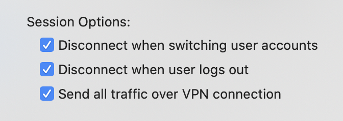

I also pass all traffic thought the VPN
