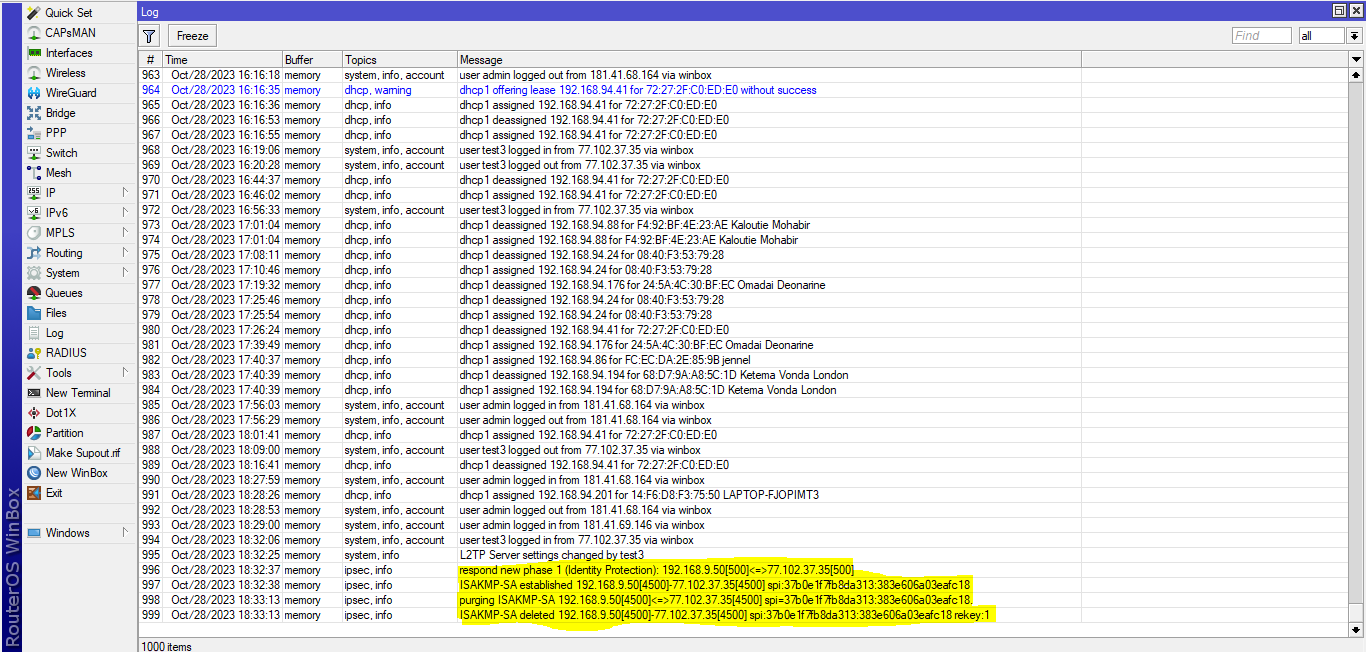

I have port forward 1701, 500, 4500, 5500, and 50 in my ISP router and my L2TP Client on my Windows 10 Machine is not connecting. (even L2TP client connect successfully with other Mikrotik 750) but not on the Windows client. I have attached a log file.
Please help me
respond new phase 1 (Identity Protection): 192.168.9.50[500]<=>77.102.37.35[500]
ISAKMP-SA established 192.168.9.50[4500]-77.102.37.35[4500] spi:37b0e1f7fb8da313:383e606a03eafc18
purging ISAKMP-SA 192.168.9.50[4500]<=>77.102.37.35[4500] spi=37b0e1f7fb8da313:383e606a03eafc18.
ISAKMP-SA deleted 192.168.9.50[4500]-77.102.37.35[4500] spi:37b0e1f7fb8da313:383e606a03eafc18 rekey:1

yes, it was a problem or maybe a bug with windows.
I have fixed it yesterday night thanks
