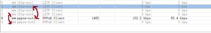

If I have many PPPoE links, can I specify which use PPPoE line for all data of L2TP client?
for example:
l2tp-out2 --》 pppoe-out1
l2tp-out4 --》 pppoe-out2
I’m from China, so the description of the problem is not very detailed ! sorry
for example:
