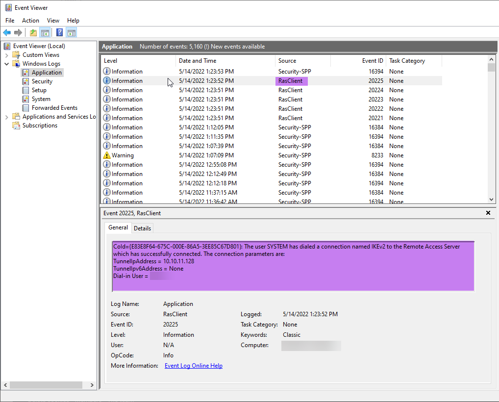

Event viewer Windows ERRORS are usually generic but still worth it.
