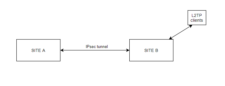

I want to make L2TP clients to be able to talk to devices over IPsec tunnel, like in the picture below. E.g. users that are connected via L2TP they could be able to reach Site A devices.
Site A and site B has a mikrotik routers.
The thing is that since packet flying through ipsec tunnels, they are encrypted. And I don’t really figured it out how to properly make this scenario working.
I tried adding routes, firewall rules with forwards but every time I end up packets flying via WAN not via IPsec tunnel (for L2TP clients). I’m just wondering how properly should I make this so from L2tp clients site A would be visible to them.
In any case I don’t need that internet would be reachable via Site A router.

There are formatting issues when using some skins (at least the default one), adding some empty lines before the second code block fixes that.
Regarding your issue: you use a pool 192.168.200.50-192.168.200.150 for the L2TP clients, but you only have an IPsec policy dst-address=192.168.1.0/24 src-address=192.168.120.0/24 (at Site B).
To allow the L2TP clients to reach 192.168.1.0/24 as well, you have to add another IPsec policy at each router - a copy of the already existing one but with 192.168.200.0/24 instead of 192.168.120.0/24 at the appropriate place (src-address at Site B and dst-address at Site A).
The action=accept rules in chain=srcnat of /ip firewall nat have to be added too; on the other hand, you can remove those of these rules where the local subnet is matched as dst-address. So at Site B, the following chain=srcnat action=accept rules are sufficient:
src-address=192.168.120.0/24 dst-address=192.168.1.0/24
src-address=192.168.200.0/24 dst-address=192.168.1.0/24
Also, have a better look at how the stateful firewall works:
First, there is no action=drop rule in the forward chain, so transit traffic is not restricted in any way (the presence of NAT is not a 100 % protection against attacks from outside if the attacker knows the LAN addresses).
Second, you’ve placed permissive rules before the “accept established, related” ones, which is a waste of CPU.
Next, you have one action=accept rule matching on src-address and dst-address of the LAN subnets, and then other action=accept rules matching on ipsec-policy which are shadowed by the previous one. This is not a waste of CPU but may be a source of surprises.
Thanks for your reply.
So basically, if I would change L2TP clients’ pool from “vpn” to “dhcp” then I should be able to reach site A, right?
I think that could be the solution to go.
I also tried your suggestion. I created exact copy of existing IPsec policy with same name but with different addresses but still I was not able to ping site A from L2TP client. But that’s probably because I didn’t rebooted routers.
EDIT:
I changed pool to “dhcp”. Now I am able to ping site A but can’t reach site B at all.
This would work, but you would have to take other measures to make L2TP clients talk to devices in Site B’s LAN subnet (or, more precisely, the devices in Site B’s LAN subnet to deliver packets to the L2TP clients). So I would not go this way.
No, reboot is not necessary. Check that the newly added policies are active at both routers, and if yes, check the firewall rules at Site A - I haven’t looked at them at all. And as I wrote, it is not enough to add the policies, you also have to exclude the connections from 192.168.200.0/24 to 192.168.1.0/24 from getting src-nated at Site B.
OK, so I added in firewall so called NAT loopback rule with src address 192.168.120.0/24 and dst address 192.168.120.0/24 and now it seems I am able to reach site B and site A from L2TP client.
Nice. Thank you for your suggestions.
Why a “NAT loopback” rule with same src-address and dst-address should help makes little sense to me. Either it is a typo or something else has actually helped. Can you post the current exports of both machines?
Basically I went with changing dhcp pool to “dhcp” for my scenario. It actually makes sense to me since L2TP clients are not able to reach Site B so NAT loops it back to the same network. Since you said that, I tried to disable that rule and again tried to ping or RDP to server with no luck. Enabled that rule back it allows me to reach Site B from L2TP client. I also can see counter adding numbers each time I make a request to the 192.168.120.0/24 from L2TP client.
