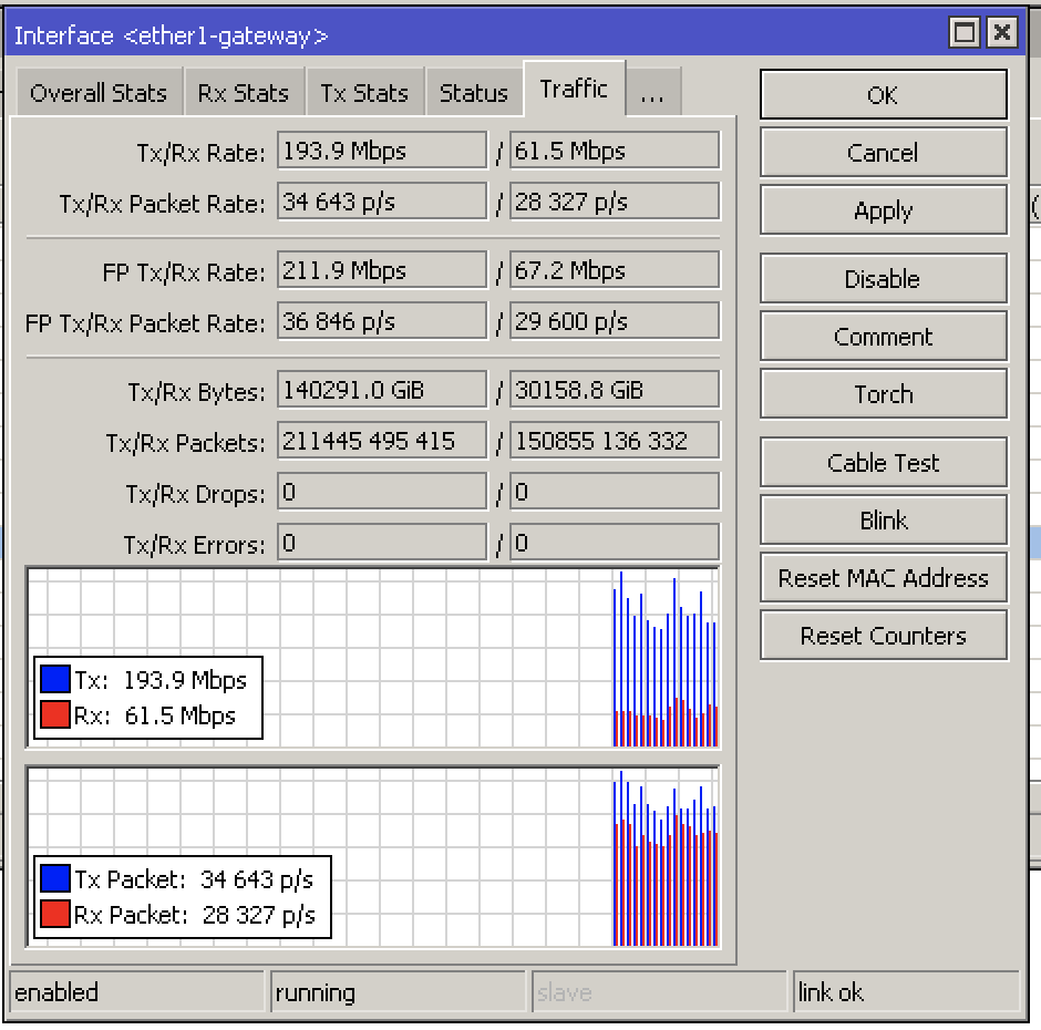

Ether1-gateway FastPath is active for both tx and rx

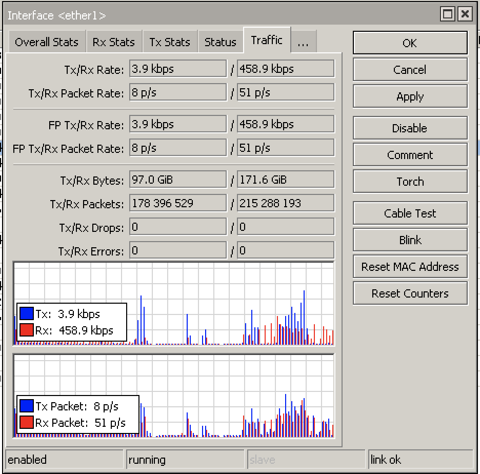

Ether1 FastPath is active for both tx and rx

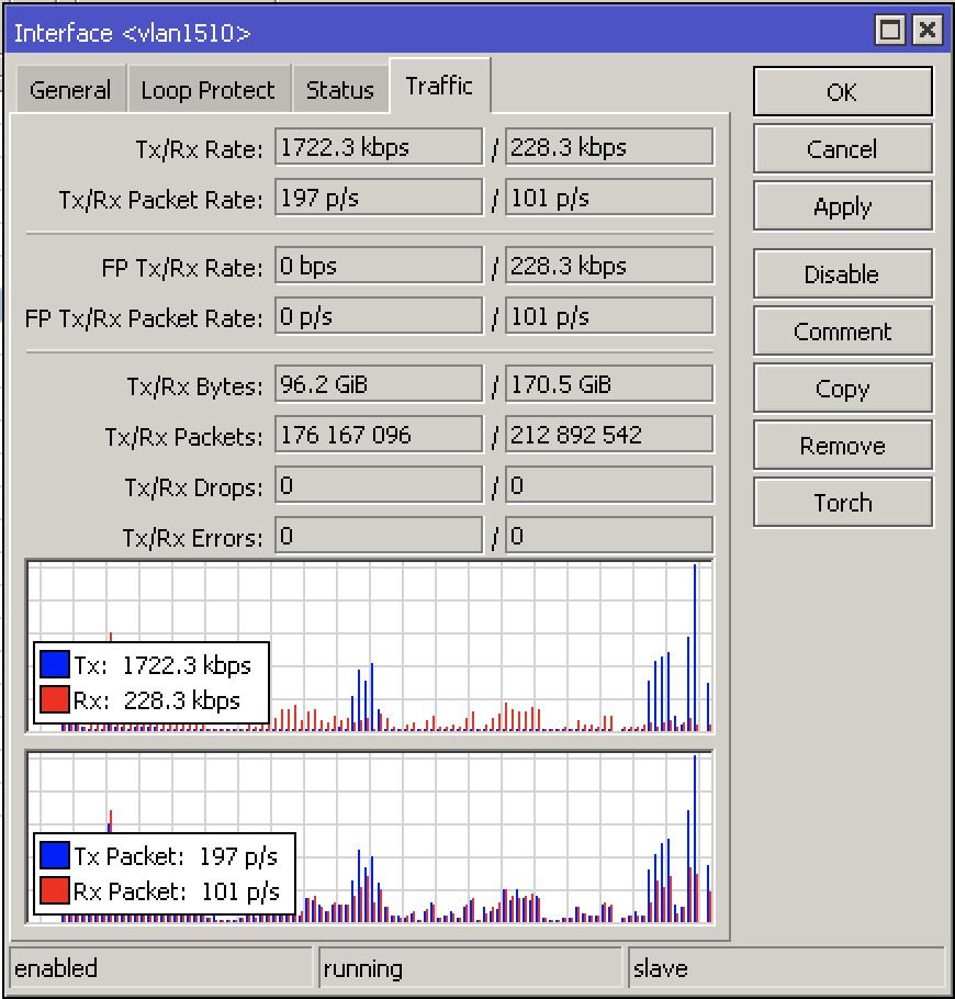

Vlan 1510 FastPath is active for rx only

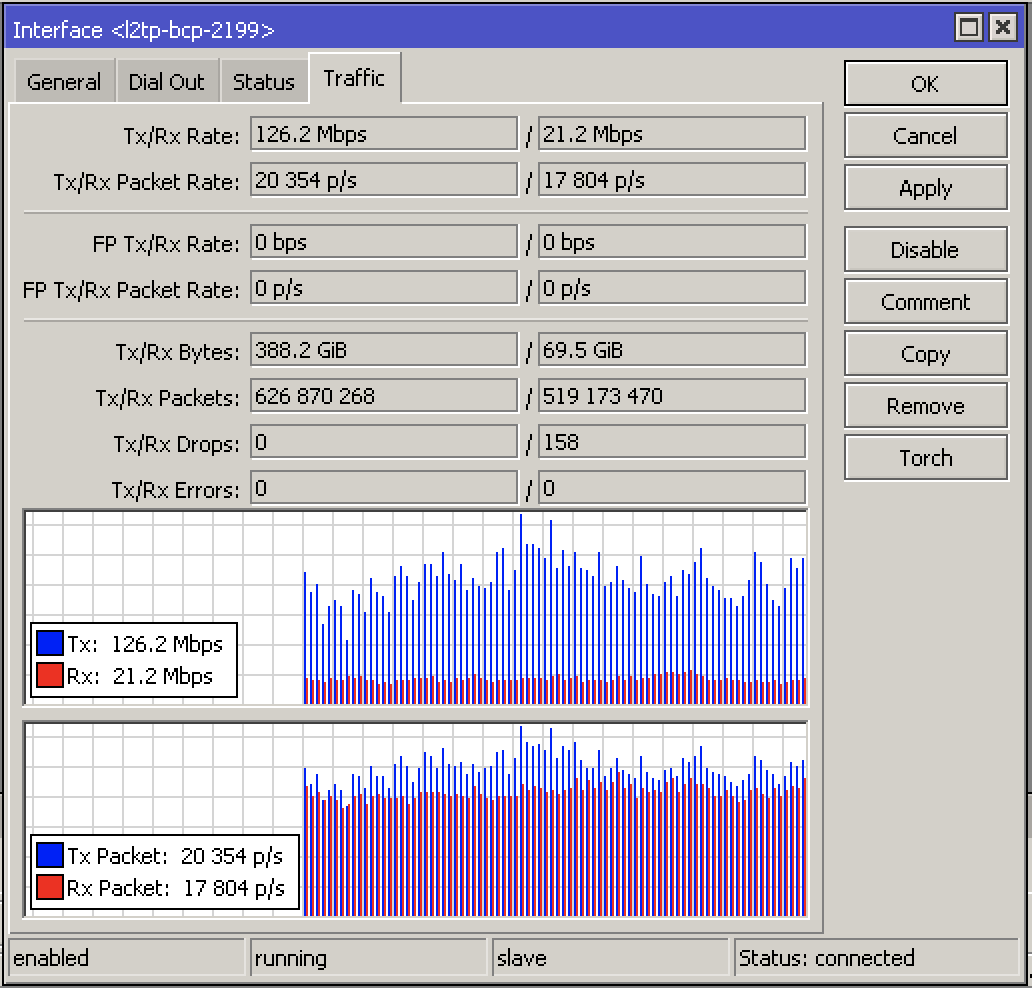

L2TP FastPath is not active.
If I replace L2TP with EoIP, then FastPath becomes active for both rx and tx on Vlan 1510 and EoIP interfaces.

I messed some more time with this trouble and I figured out that if traffic originated from Mikrotik itself (attach IP to l2tp interface and ping anything from it) then I get FP for RX on L2TP. If traffic passes thru the bridge then no FP for L2TP. I want to remind that L2TP is a part of a bridge (BCP).
My L2TP server is a plain simple config with only mRRu set for 1614 and added profile for BCP. Client config is the same. FP enabled on both sides. I don’t use any encryption at all.
Does L2TP support FP for both TX and RX?
Why there is no FP when L2TP is a part of a bridge?

You can replicate this issue yourself. Just add L2TP interface to a bridge (add bridge interface to ppp profile on both sides of the tunnel) and FP disappears.
That is correct…
