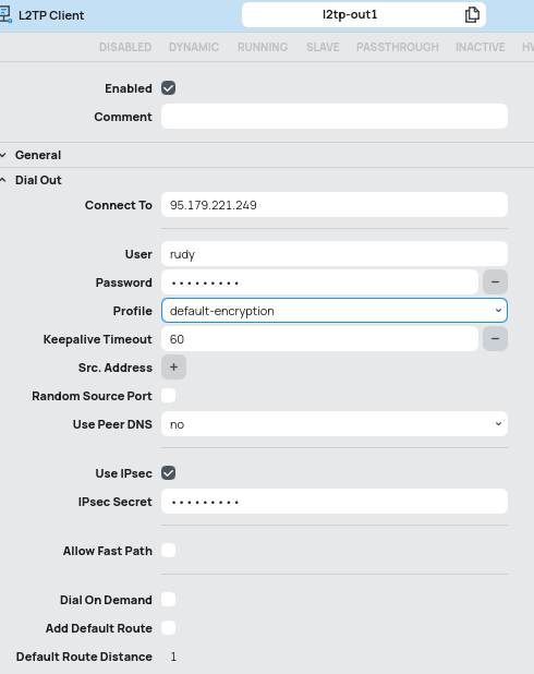

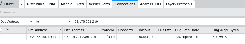

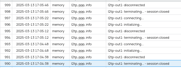

I want to configure an L2TP VPN connection with IPSec between a Peplink router as a server and a Mikrotik router. The Mikrotik router doesn’t connect; the firewall shows an attempt to connect to the server on port 1701, then nothing. I used the same settings (user account, password, server address) on an iPhone and Windows 10 connected behind the Mikrotik, and the VPN is successfully established. On the Mikrotik’s firewall, I see an initial connection on port 500, then on port 4500 when the VPN is established.
Below is my VPN configuration on Mikrotik and the logs.
