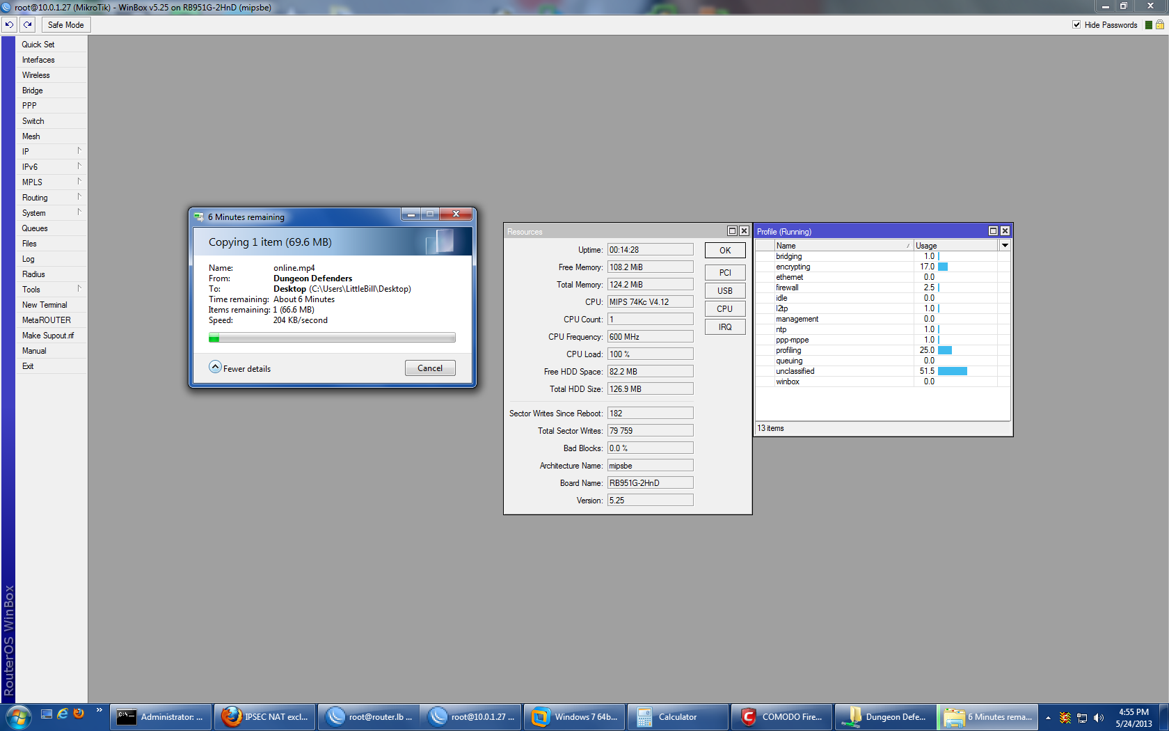

L2tp/IPSEC performance blows?
picture says it all, less then 1 mbit on a 750, barely 2 mbit on a 951
this was lan-lan tested over gigabit
anyone?
i can do roughly 44mbit on pptp
support says i should be able to do 20mbit on 750, does not appears that is really true?
anyone else seeing similar results.
i’m going to pop another ticket, but i’m not expecting much

Looks like you are missing a proposal.
Try something like the following:
/ip ipsec proposal
set [ find default=yes ] auth-algorithms=sha1 disabled=no enc-algorithms=\
    aes-128 lifetime=30m name=default pfs-group=none
/ip ipsec peer
add address=0.0.0.0/0 auth-method=pre-shared-key dh-group=modp1024 disabled=no \
    dpd-interval=2m dpd-maximum-failures=5 enc-algorithm=3des exchange-mode=\
    main-l2tp generate-policy=yes hash-algorithm=sha1 lifetime=1d \
    my-id-user-fqdn="" nat-traversal=yes port=500 secret=mypassphrase \
    send-initial-contact=yes
Just to add to this, using aes-128 and md5 you can easily get 15mbit of IPSec encrypted traffic on a 750GL.
GRE over IPSec example here.
can you provide your export?
mine is attached. i still can’t get AES encyrpt to work throws the dh group error
i even built a lab x86 box and 2 vms and the results are the same as my 750
please help i feel its something stupid

tried with 6.0 as well same error
someone throw me a bone…
log.1.txt (7.11 KB)
log.0.txt (4.82 KB)
Watch the presentation in my sig.
Tweak the encryption and hashing algo’s to suit your needs/speeds.
i did, i see nothing different then what you did, and sha1 des3 works flawless, only when i change encryption does it not work
and i can’t find the reason why
can u just take a look and see what you think
Change
/ip ipsec peer
add enc-algorithm=aes-128 generate-policy=yes hash-algorithm=sha1 \
    nat-traversal=yes secret=1234
to
/ip ipsec peer
add exchange-mode=main-l2tp enc-algorithm=3des generate-policy=yes hash-algorithm=sha1 \
This is only for phase I of the l2tp connection and will allow windows clients to connect.
i dont want to use 3des, thats the point of this, the performance blows on that
windows also supports aes-128 sha1, by default which im being told has much better performance
i need this to work under aes 128, not 3des i already had that working
The phase I encryption is only for the keys being passed, not the data. If you want to use windows clients, they only support 3des on phase I.
ok good to know
do you have a kb article or something that indicates that, i looked over the microsoft articles for a while and didn’t see that mentioned
As mentioned before, for Phase 1, windows only supports 3des and sha1.
You have many options for Phase 2 however, and Windows will adapt to your phase 2 config.
i reconfigured with aes,
and it connects i was not able to use md5 in the proposal it never connected.
i got a boost, but performance still sucked on my 750, i was barely able to breake 100k on upload from client and barely 200k on download.
god knows why its not symmetrical, but at this point im tired of playing
my lab vm with dual core 3.0’s can do over 100+mbit on ds3, so apparently my config isn’t bad
oh well when i mentally can handle it i will come back and attempt it again at some point
thanks for the help
