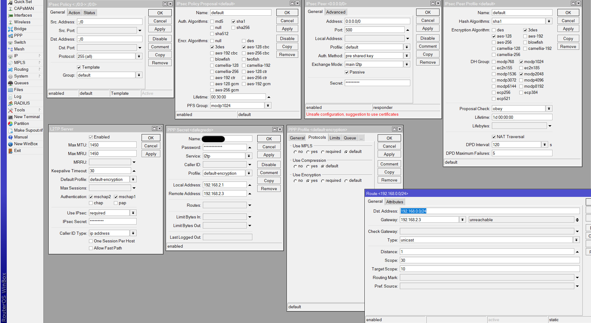

Hi. Until recently I have been working fine with the l2tp / ipsec protocol. Now, I do not know why it fails and I get the following message in log:
xx.xx.xx.xx failed to pre-process for ph2 packet
xx.xx.xx.xx peer sent packet for dead phase2
In the ipsec window I get the following message:
Unsafe configuration suggestio to use certificates.
Now it is necessary to work with certificates?
Thank you
I forgot to put the configuration
make filter accept for IPsec port=500,4500. And also L2TP
I already had it done, I forgot to put it
Thank you very much, it worked. What was he doing wrong?
