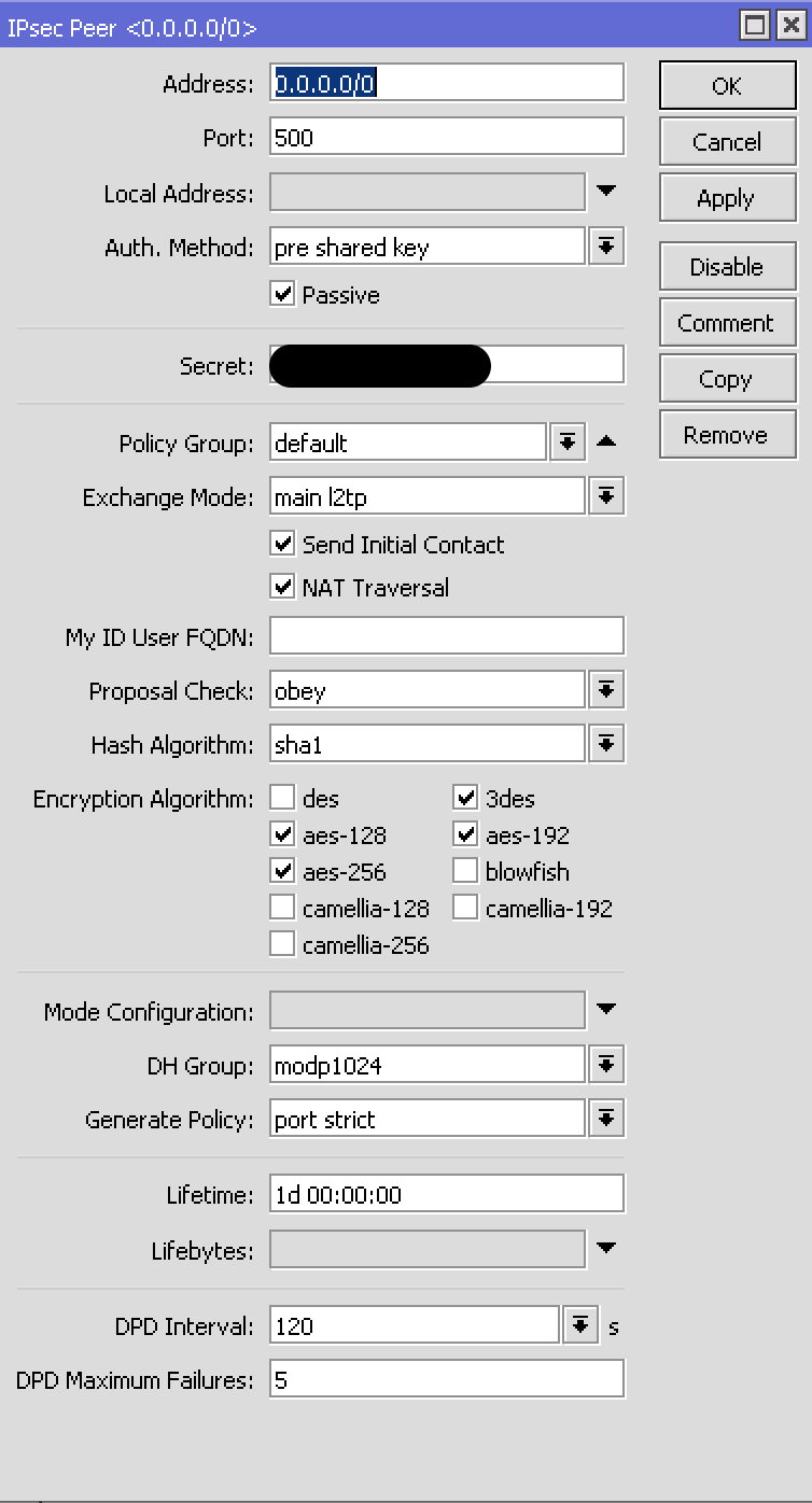

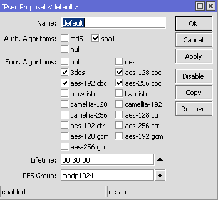

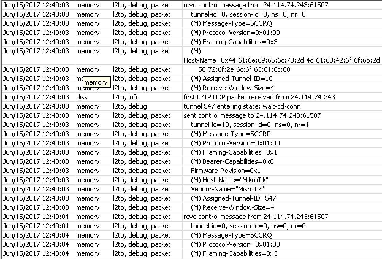

The log below is a failed attempt to connect from my Mac via hotspot on my android phone, this same long will repeat consecutively about 8 times before it times out and pops an error on the mac stating the L2TP server did not respond.

Remove the AES-192 and AES-256 encr algo in IPsec Peer.
Set generate policy to “port override”.
