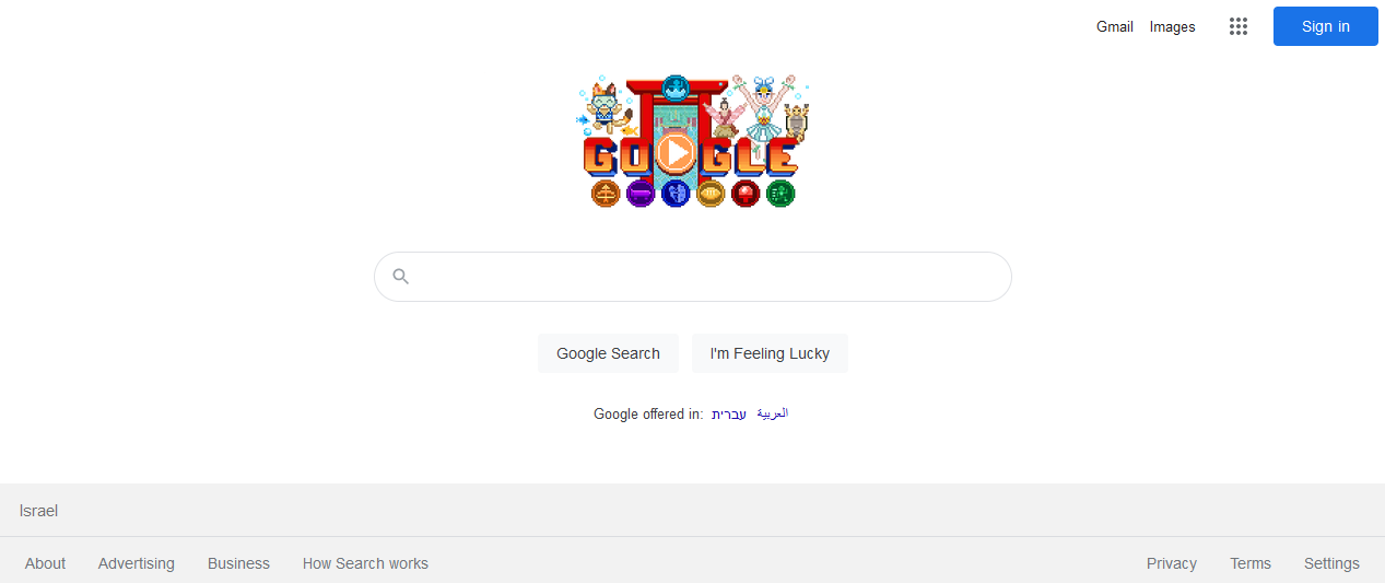

Tried your suggestion of settings => privacy => Permissions => Location to block new requests for location. Cleared cache, closed and then reopened firefox. Open google.com and it shows the location of the computer. Location permissions is not the issue.

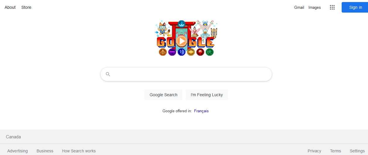

Disconnected from CCR VPN, cleared cache in firefox then connected to the hEX S VPN. Open google.com and it sees my computer in Canada.
