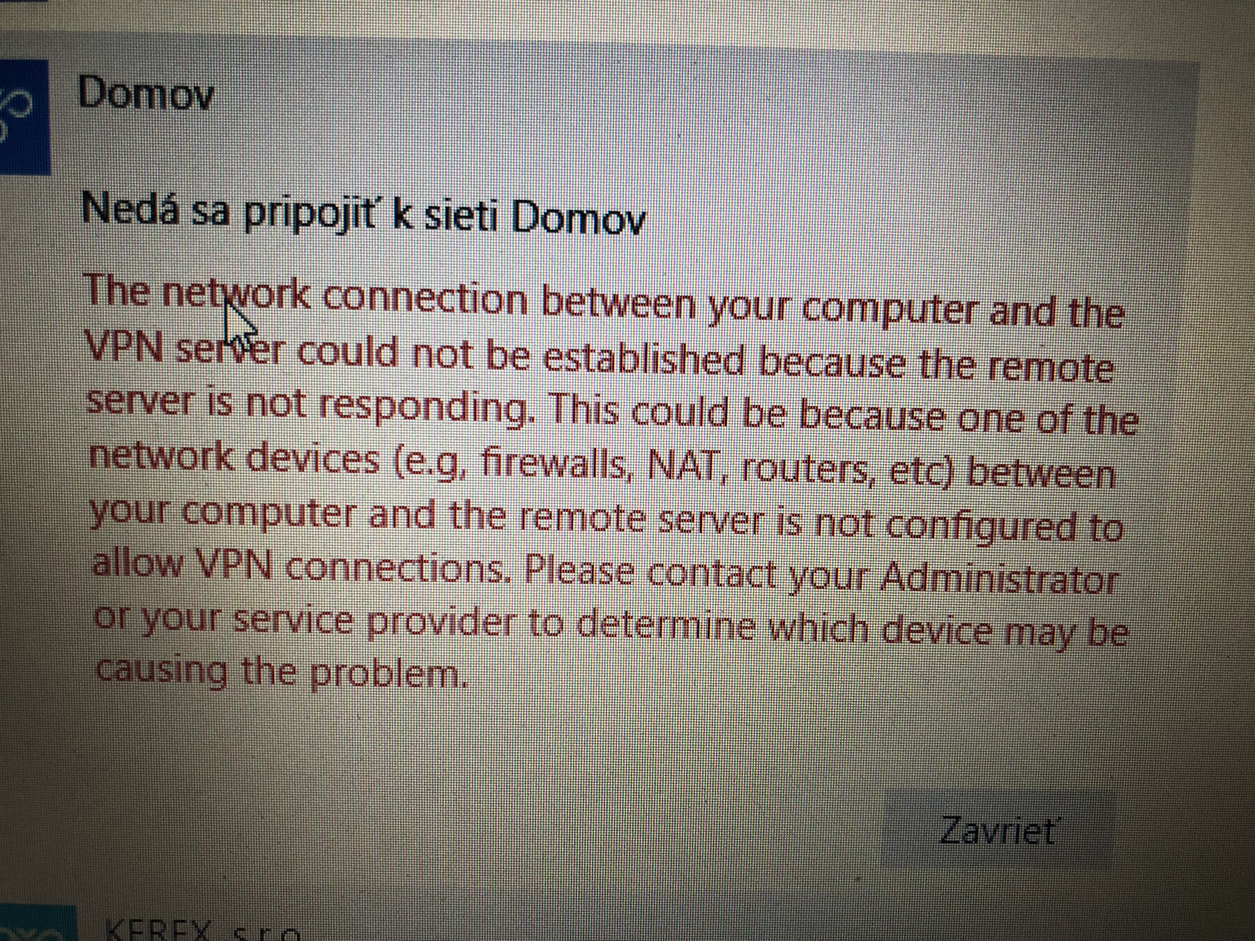

have VPN in my mikrotik. Worked perfect. Some days ago my ISP changed ONT mode from bridge to Route mode so I enabled DMZ in ONT to my Mikrotik.
Problem is VPN doesn’t work. If I’m connecting from apple devices (iPhone, iPad, MacBook Pro) it works fine but if I want to connect from Windows 10 laptop, it doesn’t work. In that time windows got some bigger update, maybe this is a problem.
Any fix please?
ONT: 192.168.1.1
Mikrotik: 192.168.1.6
IP Pool in Mikrotik: 10.31.0.100-10.31.0.20
Followed this guide to create VPN: https://saputra.ch/setup-mikrotik-as-l2tp-ipsec-vpn-server/
Thank you so much.

20:49:32 ipsec,debug succeed.
20:49:32 ipsec,debug transform #1 len=44
20:49:32 ipsec,debug type=Encryption Mode, flag=0x8000, lorv=UDP-Transport
20:49:32 ipsec,debug UDP encapsulation requested
20:49:32 ipsec,debug type=Key Length, flag=0x8000, lorv=256
20:49:32 ipsec,debug type=Authentication Algorithm, flag=0x8000, lorv=hmac-sha1
20:49:32 ipsec,debug type=SA Life Type, flag=0x8000, lorv=seconds
20:49:32 ipsec,debug type=SA Life Duration, flag=0x0000, lorv=4
20:49:32 ipsec,debug type=SA Life Type, flag=0x8000, lorv=kilobytes
20:49:32 ipsec,debug proposal #2 len=56
20:49:32 ipsec,debug begin.
20:49:32 ipsec,debug seen nptype=3(trns) len=44
20:49:32 ipsec,debug type=Key Length, flag=0x8000, lorv=128
20:49:32 ipsec,debug proposal #3 len=52
20:49:32 ipsec,debug seen nptype=3(trns) len=40
20:49:32 ipsec,debug transform #1 len=40
20:49:32 ipsec,debug proposal #4 len=52
20:49:32 ipsec,debug proposal #5 len=52
20:49:32 ipsec,debug pair 1:
20:49:32 ipsec,debug  0x48e860: next=(nil) tnext=(nil)
20:49:32 ipsec,debug proposal #1: 1 transform
20:49:32 ipsec,debug pair 2:
20:49:32 ipsec,debug  0x48dfa0: next=(nil) tnext=(nil)
20:49:32 ipsec,debug proposal #2: 1 transform
20:49:32 ipsec,debug pair 3:
20:49:32 ipsec,debug  0x48b908: next=(nil) tnext=(nil)
20:49:32 ipsec,debug proposal #3: 1 transform
20:49:32 ipsec,debug pair 4:
20:49:32 ipsec,debug  0x48eb28: next=(nil) tnext=(nil)
20:49:32 ipsec,debug proposal #4: 1 transform
20:49:32 ipsec,debug pair 5:
20:49:32 ipsec,debug  0x48e878: next=(nil) tnext=(nil)
20:49:32 ipsec,debug proposal #5: 1 transform
20:49:32 ipsec,debug got the local address from ID payload xxx.xxx.xxx.xxx[1701] prefixlen=32 ul_proto=17
20:49:32 ipsec,debug got the peer address from ID payload 172.20.10.2[1701] prefixlen=32 ul_proto=17
20:49:32 ipsec,debug updating policy address because of NAT in transport mode
20:49:32 ipsec,debug new local address 192.168.1.6[1701]
20:49:32 ipsec,debug new peer address xxx.xxx.xxx.xxx[1701]
20:49:32 ipsec searching for policy for selector: 192.168.1.6:1701 ip-proto:17 <=> xxx.xxx.xxx.xxx:1701 ip-proto:17
20:49:32 ipsec recorded wild match: 192.168.1.6 <=> xxx.xxx.xxx.xxx ip-proto:17
20:49:32 ipsec,debug  (proto_id=ESP spisize=4 spi=00000000 spi_p=00000000 encmode=UDP-Transport reqid=4:4)
20:49:32 ipsec,debug   (trns_id=AES-CBC encklen=128 authtype=hmac-sha1)
20:49:32 ipsec,debug   (trns_id=3DES encklen=0 authtype=hmac-sha1)
20:49:32 ipsec,debug begin compare proposals.
20:49:32 ipsec,debug pair[1]: 0x48e860
20:49:32 ipsec,debug prop#=1 prot-id=ESP spi-size=4 #trns=1 trns#=1 trns-id=AES-CBC
20:49:32 ipsec,debug peer's single bundle:
20:49:32 ipsec,debug  (proto_id=ESP spisize=4 spi=9ba10732 spi_p=00000000 encmode=UDP-Transport reqid=0:0)
20:49:32 ipsec,debug   (trns_id=AES-CBC encklen=256 authtype=hmac-sha1)
20:49:32 ipsec,debug my single bundle:
20:49:32 ipsec Adjusting my encmode UDP-Transport->Transport
20:49:32 ipsec Adjusting peer's encmode UDP-Transport(4)->Transport(2)
20:49:32 ipsec key length mismatched, mine:128 peer:256.
20:49:32 ipsec trns_id mismatched: my:3DES peer:AES-CBC
20:49:32 ipsec,debug not matched
20:49:32 ipsec,debug pair[2]: 0x48dfa0
20:49:32 ipsec,debug prop#=2 prot-id=ESP spi-size=4 #trns=1 trns#=1 trns-id=AES-CBC
20:49:32 ipsec,debug  (proto_id=ESP spisize=4 spi=00000000 spi_p=00000000 encmode=Transport reqid=4:4)
20:49:32 ipsec,debug matched
20:49:32 ipsec,debug ===
20:49:32 ipsec,debug call pfkey_send_getspi 12
20:49:32 ipsec,debug pfkey GETSPI sent: ESP/Transport xxx.xxx.xxx.xxx[26225]->192.168.1.6[4500]
20:49:32 ipsec,debug pfkey getspi sent.
20:49:32 ipsec,debug total SA len=64
20:49:32 ipsec,debug 00000001 00000001 00000038 02030401 00000000 0000002c 010c0000 80040004
20:49:32 ipsec,debug 80060080 80050002 80010001 00020004 00000e10 80010002 00020004 0003d090
20:49:32 ipsec,debug seen nptype=2(prop) len=56
20:49:32 ipsec,debug  0x48c560: next=(nil) tnext=(nil)
20:49:32 ipsec,debug NAT-OAi:
20:49:32 ipsec,debug 01006671 55edead3
20:49:32 ipsec,debug NAT-OAr:
20:49:32 ipsec,debug 01001194 c0a80106
20:49:32 ipsec,debug add payload of len 64, next type 10
20:49:32 ipsec,debug add payload of len 24, next type 5
20:49:32 ipsec,debug add payload of len 8, next type 5
20:49:32 ipsec,debug add payload of len 8, next type 21
20:49:32 ipsec,debug add payload of len 8, next type 0
20:49:32 ipsec,debug HASH with:
20:49:32 ipsec,debug 00000005 ef55b1a1 3e439de4 cff04bfe ffd7c852 04ffdf65 6760daeb 37c9c8d3
20:49:32 ipsec,debug dc5f88df c25b304a d9e50425 0ded45c8 e9df9512 0a000044 00000001 00000001
20:49:32 ipsec,debug 00000038 02030401 0afe5506 0000002c 010c0000 80040004 80060080 80050002
20:49:32 ipsec,debug 80010001 00020004 00000e10 80010002 00020004 0003d090 0500001c 8b10d494
20:49:32 ipsec,debug 74c99b4f e372de55 11a89e51 429488b0 37cbc736 0500000c 011106a5 ac140a02
20:49:32 ipsec,debug 1500000c 011106a5 5f673344 1500000c 01006671 55edead3 0000000c 01001194
20:49:32 ipsec,debug c0a80106
20:49:32 ipsec,debug hmac(hmac_sha1)
20:49:32 ipsec,debug HASH computed:
20:49:32 ipsec,debug 9a791540 f834810d 03396ca7 47f7f480 eeae0f9e
20:49:32 ipsec,debug add payload of len 20, next type 1
20:49:32 ipsec,debug begin encryption.
20:49:32 ipsec,debug encryption(3des)
20:49:32 ipsec,debug pad length = 8
20:49:32 ipsec,debug 01000018 9a791540 f834810d 03396ca7 47f7f480 eeae0f9e 0a000044 00000001
20:49:32 ipsec,debug 00000001 00000038 02030401 0afe5506 0000002c 010c0000 80040004 80060080
20:49:32 ipsec,debug 80050002 80010001 00020004 00000e10 80010002 00020004 0003d090 0500001c
20:49:32 ipsec,debug 8b10d494 74c99b4f e372de55 11a89e51 429488b0 37cbc736 0500000c 011106a5
20:49:32 ipsec,debug ac140a02 1500000c 011106a5 5f673344 1500000c 01006671 55edead3 0000000c
20:49:32 ipsec,debug 01001194 c0a80106 a0400bcd cda73707
20:49:32 ipsec,debug with key:
20:49:32 ipsec,debug 51f7282d 49196f28 3abba3b5 ad526b2c 542c9d04 520544cc
20:49:32 ipsec,debug encrypted payload by IV:
20:49:32 ipsec,debug 632f0316 6503078f
20:49:32 ipsec,debug save IV for next:
20:49:32 ipsec,debug 0e358d1f 5b1bc8af
20:49:32 ipsec,debug encrypted.
20:49:32 ipsec,debug 204 bytes from 192.168.1.6[4500] to xxx.xxx.xxx.xxx[26225]
20:49:32 ipsec,debug 1 times of 208 bytes message will be sent to xxx.xxx.xxx.xxx[26225]
20:49:32 ipsec,debug,packet 22d3caa2 d3c1742c 871e0ec7 f5ec59ad 08102001 00000005 000000cc 421b904b
20:49:32 ipsec,debug,packet b4f91758 baf08bce 8250d83f 720db4b0 fe695767 605dfd23 6616bedb 2e109415
20:49:32 ipsec,debug,packet 7493811a 5826eb62 ce5fda91 32bacfef 281b6b7a bbdd9846 a1661373 9b7afb36
20:49:32 ipsec,debug,packet b6539c52 18b77a47 fb5fa952 b4aecb19 f94382c5 e0c2d767 7e13fbe6 686425de
20:49:32 ipsec,debug,packet de0986b0 16901e9c 2412051e e9cec04a c6e8d0d8 f7cadc17 7c8352a2 286fdcd9
20:49:32 ipsec,debug,packet 507e0b47 d7e7b22b 4fa55440 cb6d388a 07cb6705 cc0a3c07 9bac3efb 43e7523d
20:49:32 ipsec,debug,packet 978de7d7 0e358d1f 5b1bc8af
20:49:32 ipsec sent phase2 packet 192.168.1.6[4500]<=>xxx.xxx.xxx.xxx[26225] 22d3caa2d3c1742c:871e0ec7f5ec59ad:00000005
20:49:32 ipsec,debug ===== received 60 bytes from xxx.xxx.xxx.xxx[26225] to 192.168.1.6[4500]
20:49:32 ipsec,debug,packet 22d3caa2 d3c1742c 871e0ec7 f5ec59ad 08102001 00000005 0000003c d9834654
20:49:32 ipsec,debug,packet fb91c9f6 485ec59c f6c048bc e7fc0e01 5dce522c 62f9133a 5699dcc6
20:49:32 ipsec,debug IV was saved for next processing:
20:49:32 ipsec,debug 62f9133a 5699dcc6
20:49:32 ipsec,debug decrypted payload by IV:
20:49:32 ipsec,debug decrypted payload, but not trimed.
20:49:32 ipsec,debug 00000018 8affc7d9 113362d4 5b3a4cff 4c972753 ff793fc1 00000000 00000000
20:49:32 ipsec,debug padding len=1
20:49:32 ipsec,debug skip to trim padding.
20:49:32 ipsec,debug decrypted.
20:49:32 ipsec,debug 22d3caa2 d3c1742c 871e0ec7 f5ec59ad 08102001 00000005 0000003c 00000018
20:49:32 ipsec,debug 8affc7d9 113362d4 5b3a4cff 4c972753 ff793fc1 00000000 00000000
20:49:32 ipsec,debug seen nptype=8(hash) len=24
20:49:32 ipsec,debug HASH(3) validate:

bump
I have seen in some cases be the equipment of the ISP, which is performing drop.
It’s because your L2TP/IPSec server is behind a NAT. DMZ doesn’t fix it. Registry key should. Life might be better if you change modem mode back to bridge mode.
For Windows Vista, 7, 8, 10, and 2008 Server:
HKEY_LOCAL_MACHINE\SYSTEM\CurrentControlSet\Services\PolicyAgent
RegValue: AssumeUDPEncapsulationContextOnSendRule
Type: DWORD
Data Value: 2
Note that after creating this key you will need to reboot the machine
I already have it in regedit. Didn’t help. Can’t switch ONT to bridge mode because of slow speeds of PPPoE
any other ideas please?
i can’t see picture.but. we have same situation. we have to remove modem and put mikrotik as first gateway to run l2tp ipswc.
Sent from my Moto G (5) Plus using Tapatalk
Anybody want to run a packet capture on the Mikrotik? On the Wan interface. Post the results in this thread.
Would be helpful to see what Windows is sending.
Have you tried removing the mikrotik from the DMZ and then port forward UDP 500 and 4500 to the Mikrotik IP?
What IP do you receive from ISP?
Sorry, forget to answer.
  • tried port forward (500, 4500) in Huawei ONT, didn’t help
  • can’t switch ONT to bridge mode because of slow PPPoE speeds in Mikrotik
  • have Telekom ISP
  • as I wrote if I had ONT in bridge mode, VPN works perfect. Now it doesn’t work in WIN10 only.
just reinstall WAN Miniport network drivers in Windows 10 > Right-click on Start and select Device Manager from the PowerUser menu > Expand the Network adapters section > Right-click on every individual WAN Miniport driver and uninstall - install it. this solve my problem.
RAS key? I had something similar for win10 in the past which cause by the modem block fragmented IP packets, fixed by switch to other cert make the payload smaller and don’t need fragmentation.
