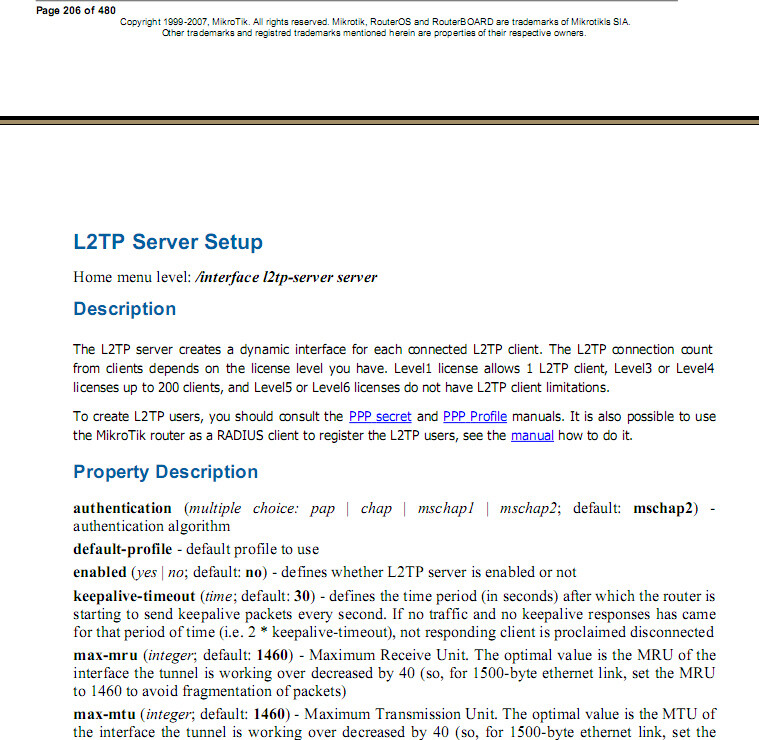

According to the manual for v3.0 L2TP-server has a keepalive-timeout setting, but in V3.30 I can’t find it.

Here, in black and white:
Link I provided earlier is the latest manual for v3,v4 and v5. Do not look at old manuals.
delete that document. where did you find it? you can see it’s at least 3 years old (see footer)
