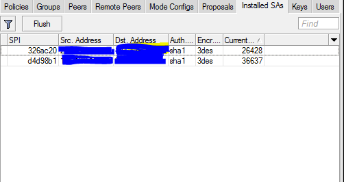

the ipsec sa is working in both directions

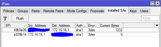

I tried to disable all firewall rules and keep only these:
 0    chain=input action=log protocol=udp
      in-interface=ether1-ToFortiGate src-port=500,1701,4500 log=yes
      log-prefix=""
 1    chain=input action=accept protocol=ipsec-esp log=no log-prefix=""
 2    chain=input action=accept protocol=udp port=4500 log=no log-prefix=""
 3    chain=input action=accept protocol=udp port=500 log=no log-prefix=""
 4    chain=input action=accept protocol=udp port=1701 log=no log-prefix=""
The ipsec sa is working in one direction only from my real ip connecting to mikrotik (172.16.16.1 is the virtual ip published on the fortigate that is working with no problems with pptp connections)
Please help with detailed solution because I didn’t leave any topic without reading and trying to understand what is happening.
I am not sure that the fortigate will “passtrough” the IPSEC-traffiic, maybe there is a special option for this. By the way. the Error in your log says that you device tries sha256, but you use sha1 in your config.
But the real problem could be that both devices are behind NAT. I dont know any way to make this work with mikrotik. I have read that there are some scripted solutions where you replace the Peer IPs of the IPSEC.
greets
I think when ipsec error is being shown in the log of the mikrotik then the ipsec traffic is be passing to it and no problem in Fortigate.
the error shown is bypassed and connection is being established with no problems on the 1st mikrotik router that has a real ip.
Today also I tested the ios 10 and it connected with no problems on the 1st router that is giving that ipsec error.
The problem is related to NAT but I am not sure how to fix it if you can help me.
