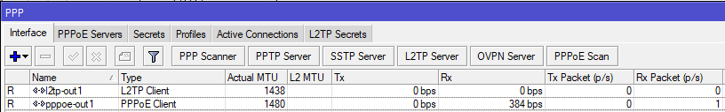

What I need to do for put L2TP over PPPoE? After I have the PPPoE functional, when I try add L2TP over PPPoE with default router for L2TP the tunnel are always up/down.

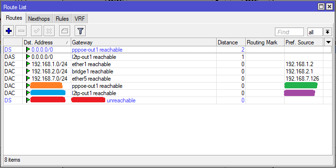

After see the teh route list, I see than one route is added as “unreachable”.
What is the problem and what I need do?
NOTE: in the picture “Route List”, the lines with the same color, they correspond the same IP.
