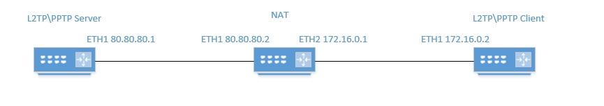

Greetings. I have issue with Mikrotik acting as a PPTP\L2TP client when it is behind NAT. Here is my setup(ITS a test environment with CHR’s on VirtualBox):
The problem is that Client wont connect to Server. When i try to monitor connections on a NAT router there is nothing. Literally. No connections to 80.80.80.1 from 172.16.0.2. The PPTP\L2TP interface receive strange ip’s

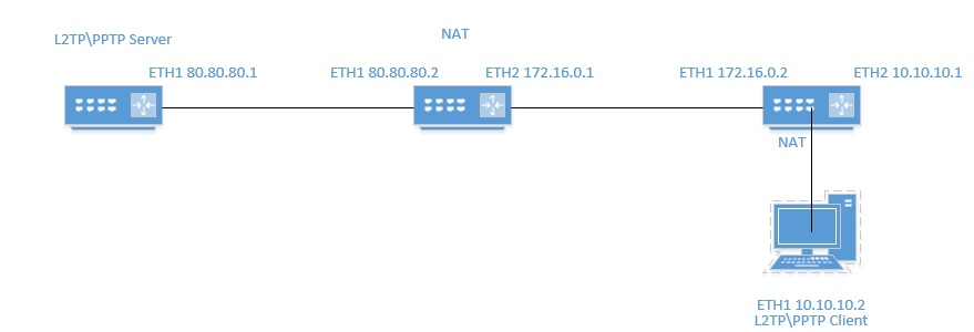

To see if the issue is in Mikrotik L2TP\PPTP client i have added a windows PC as a client.
Now the setup looks like this.
And it works just fine! I am able to connect, receive ip address and to ping the other end of the tunnel.
