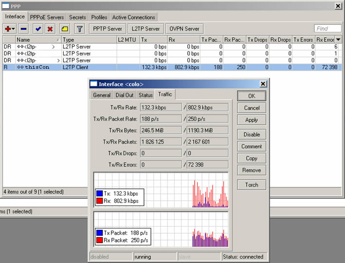

We are getting a lot of Rx errors on one of our L2TP connections. Data still gets through, slowly, but with this many errors and I’m not sure I can to depend on that link.
We’ve traded out patch cables on both ends, just not sure whats going on here.

I have 5 or 6 l2tp tunnels on 3.25. Only one of them shows this behavior as well. My assumption is that there is packet loss on that one. It’s only on RX as well. I can’t check the other end because it doesnt have the counters yet (3.17).

We changed the interfaces to a PPTP client and the error rate went to zero, dropped the MRU and the throughput went up.
May be upstream provider is eating L2TP traffic for some reason?
i have a feeling its because l2tp packets are UDP, and packets are out of order as they arrive. PPTP is using GRE and TCP and I think that handles packet reordering at a lower level.

The routers are on bonded T1’s.
sounds like packet reordering issues. can you disable one T1 and see if that fixes it ?
