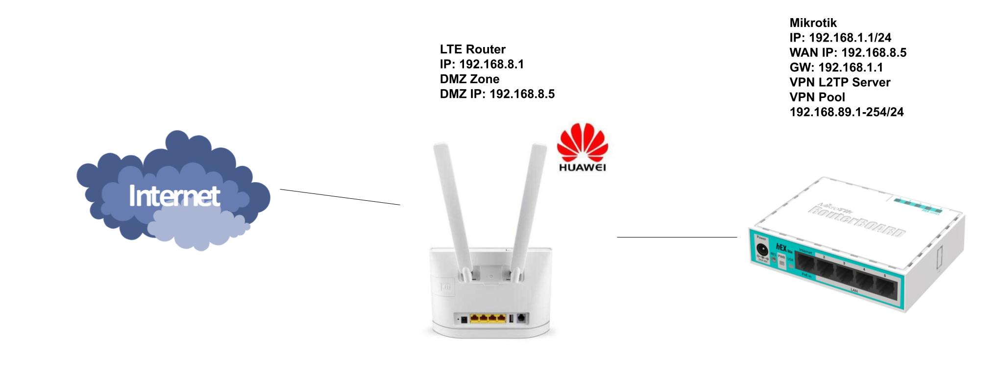

I need help. I have setup the following.
  1. LTE Internet Router with DMZ
  2. Mikrotik with L2TP Server
Test
  1. Internet is working
  2. Test VPN locally working using Windows VPN client
Problem
L2TP client doesnt want to connect from internet

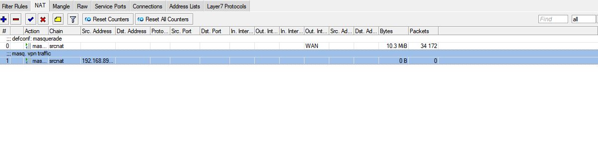

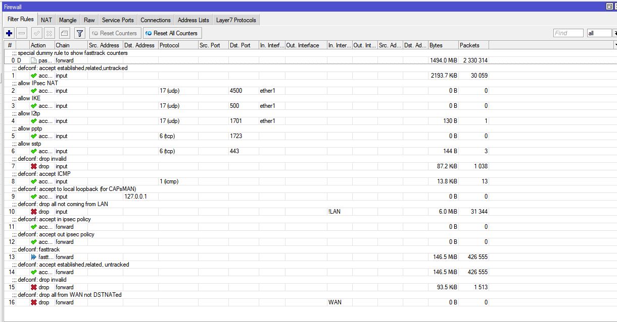

firewall.rsc (2.02 KB)

Otherwise, your Mikrotik config looks pretty standard/correct at first glance, so looks like issue may be how the DMZ works on the Huawei…

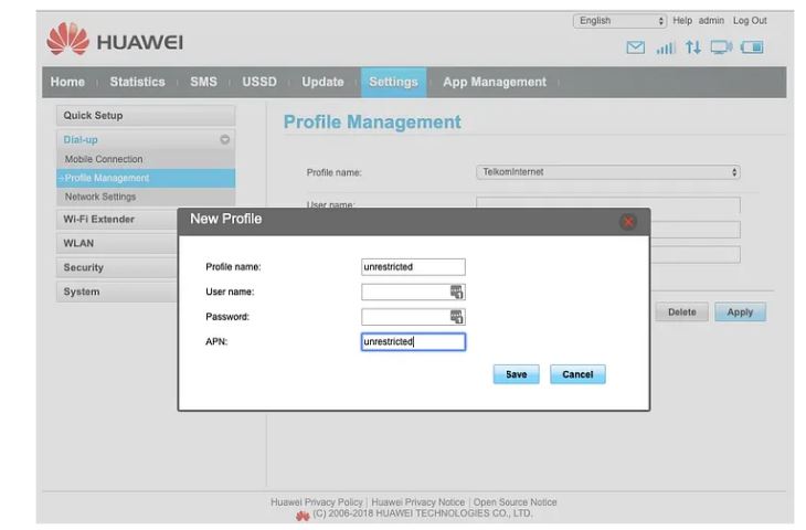

I have resolved the problem
Telkom Incoming Ports blocked - use ‘unrestricted’ APN
https://mybroadband.co.za/forum/threads/telkom-incoming-ports-blocked-use-unrestricted-apn.952185/page-3
https://archie22is.medium.com/how-to-set-up-unrestricted-apn-on-telkom-lte-3g-4634ef53af00
