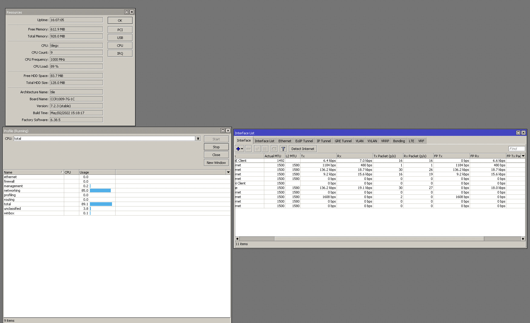

And the issue happened again today!
I just noticed, that while this is happening the CPU load is almost 100%.
Profile says it’s “networking” but there’s close to 0 network operations at the moment.
Log gives no info other than failed attempts of L2TP connection to the router and IPSec data.
