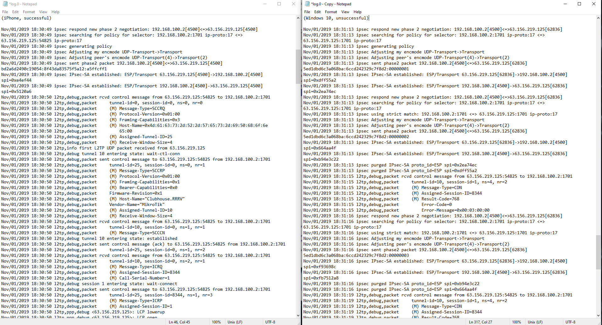

Here is a screenshot of the log with the successful iPhone connection on the left, the unsuccessful Windows 10 connection on the right.
Other than the Windows local port number, I don’t see any difference in the logs up to the point where the level 2 negotiation on the iPhone works right off the bat, while the level 2 negotiation on Windows gets retried over and over and eventually fails to connect. If Windows is proposing some phase 2 encryption protocol I haven’t enabled, I don’t know how to determine what that is from this log output.

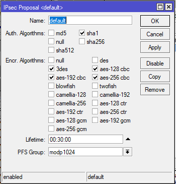

Here is an image of my proposal parameters in case it is immediately apparent to someone familiar with Windows 10 what Windows 10 may be requiring that the Mac and iPhone apparently don’t need.

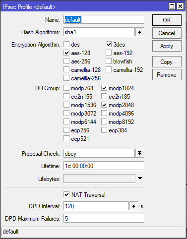

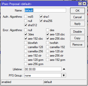

I don’t know if this is helpful to you, but these are my profile and proposal settings and they work with L2TP windows 10 clients.
