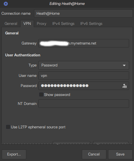

Long story short, I have set up an L2TP/IPSEC server on my router using my Linux PC as a client. While I’m connected to my home network using Winbox through my VPN I can see my list of neighbours, however when I’m connected to another network with my VPN on I can access the internet fine but Winbox loads no neighbours.
Here’s the instructional I followed https://youtu.be/FZpJGFaoFmk?si=Kxg71nqRFuyfuIFt
I have disabled all but ssh & winbox under services.

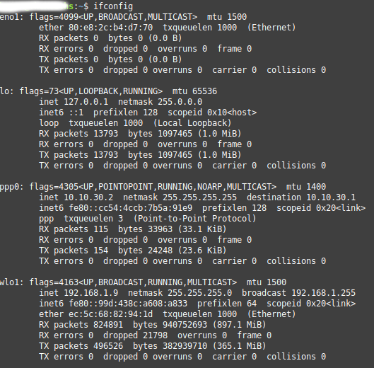

Below are a couple of screenshots which prove the VPN tunnel is working and the VPN config on my PC.

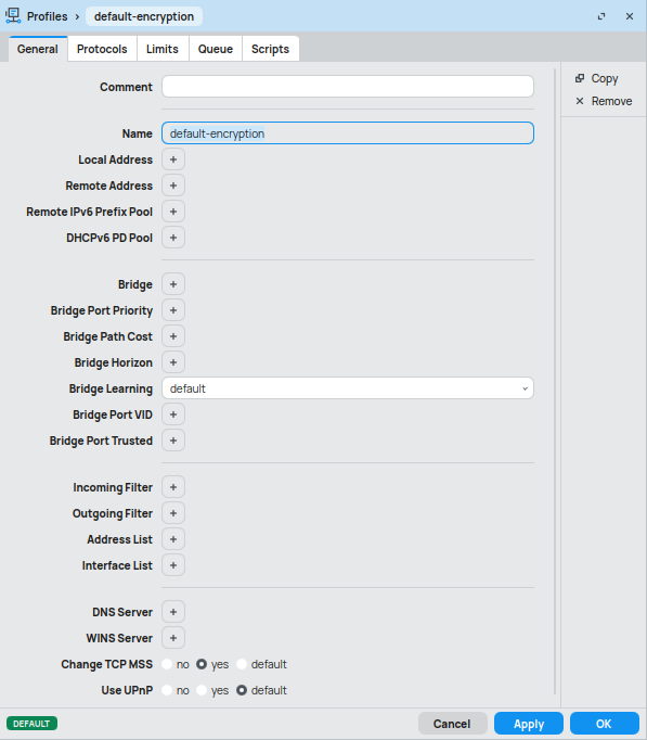

I’ve included the PPP config below and I’m picking my problem might be related to the PPP profile where it says “set *FFFFFFFE”, this doesn’t seem normal? How would I fix this?
I’m hoping someone can help me sort out the final piece of the puzzle. Cheers.
EDIT: I can confirm that I get different public IP addresses using https://whatismyipaddress.com/ when connecting from a cafe WiFi, VPN on and then off. So, further confirmation the tunnel is working, but not enough for Winbox 3 or 4 to display my router in neighbours.
[itechadmin@Home Router AX] > ppp/export
# 2025-06-04 16:30:10 by RouterOS 7.19.1
# software id = xxxx-xxxx
# model = C52iG-5HaxD2HaxD
# serial number = xxxxx
/ppp profile
set *FFFFFFFE use-encryption=default
/ppp secret
add local-address=10.10.30.1 name=vpn profile=default-encryption remote-address=10.10.30.2 \
    service=l2tp

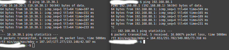

Ok, so I just used my wife’s mobile phone to hotspot and while I couldn’t still load neighbours in Winbox via my home VPN, I did manage to ping both 10.10.30.1 and my home router gateway, 192.168.88.1 as pic below.
Still a mystery why my home network doesn’t show up in neighbours when using my VPN away from home.

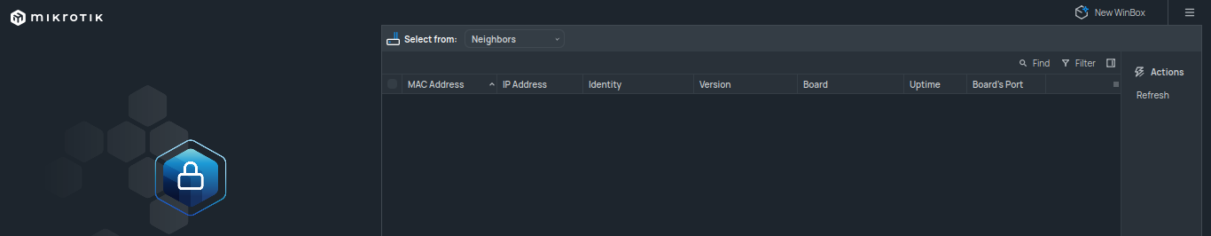

Just for clarity, this is the problem I’m having when trying to connect to my home router using my VPN from another network (cafe, public WiFi, etc…)
No neighbours are present, inc. my home router. I have tried saving my home router in the saved list, but that doesn’t do anything when activated either. I just says connecting, then times out. I can ping my home gateway when on another network, but I can’t gain access to my router through Winbox (3 or 4).
None of this is a problem when I’m on my home network using the same VPN, or with the VPN off, as expected.
I’m really sorry if this has caused any confusion.
Cheers.
If you saved them… then you need to change the view in WinBox4 to “Saved” in the dropdown near top center that says “Select From” (i.e. so it does NOT say Neighbors).
The Neighbors view listens for UDP broadcasts to 255.255.255.255, which [AFAIK] you’re not going to have with L2TP.
I understand that and tried it and found that doesn’t work either. Like I said, it hangs on connecting and then times out.
