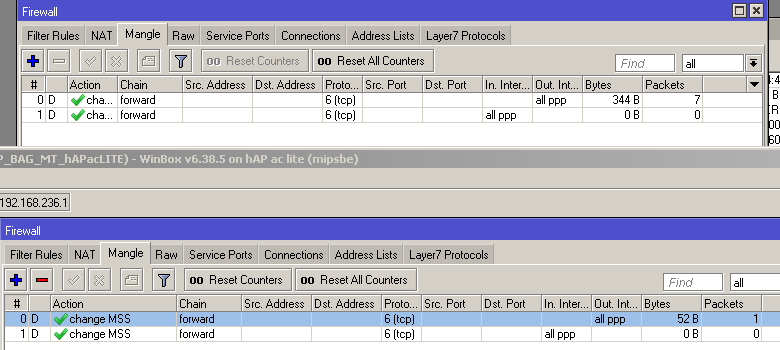

It is an MTU problem. Set up change MSS rules to lower TCP MSS.
that has already been in place… even tried lowering MTU / MRU on client side and rebooting both sides.. see attached for proof (note the D bc of the ppp profile creating the rule).
top is server, bottom is client side (in img)
EDIT: see my reply below this one, it was a MTU/MRU - just needed to be unusually low, in this specific ISP / case.
well, it was infact a MTU / MRU issue, i tried lowering the client side (l2tp-client interface) to 1300/1300 mtu/mru and the BW test works. I had stopped around 1380 when trouble shooting earlier (and lowering it incrementally and testing, but for some reason it needed to be REALLY low- so maybe its the ISP im using here on the road that has a weird config.)
