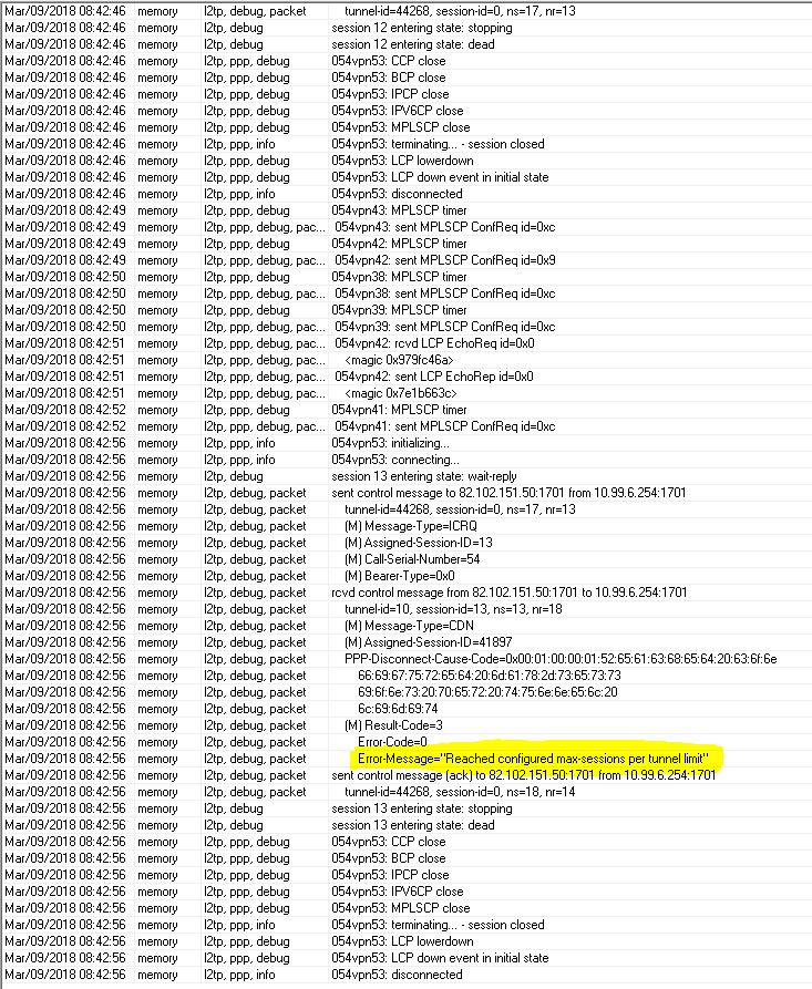

I have 20 x L2TP-Clients on a CCR router but only 16 Sessions are connecting at a time.
If i disable 4 from any of these working 16,the other non working 4 would connect.
I also did the tests by configuring these 4 non working ones on a small mikro daisy chained to the main one and they connecting right away (so just to rule out that the VPN provider is limiting the sessions per public IP).I also connected to another VPN server IP from that provider but still same problem.
I checked the logs (in attachment) and i notice something like:
Error-Message=“Reached configured max-sessions per tunnel limit”
Is that a limitation of the RouterOS Platform?

Error has nothing to do with your router. Remote server sends this error, so you should ask provider why this limit is reached.
What I was trying to hint towards, is that if it is available in Mikrotik, then the “Standard / RFC” obviously “allows for this by design”, so does not matter if ISP is using Linux, Cisco, Mikrotik, or what ever, the options is there as per RFC and maybe they configured a max session limit on their side and you should contact them
