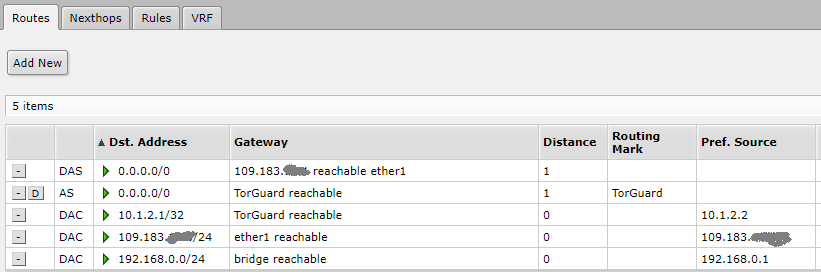

Apart from the default route with routing-mark=VPN, do you have any other default route? Or does the routing table main (the set of routes with no routing-mark) only contain a route towards the TorGuard server? In either case, what’s the outcome if you use ping 8.8.8.8 routing-table=VPN?
Passthrough enabled may or may not be important depending on whether any other rules exist in mangle chain. Although your description is clear regarding the settings related to the task, a complete configuration export is always better because it shows the other settings which may possibly have an impact.
Thanks for you replay.
Apart from the default route with > routing-mark=VPN> , do you have any other default route? Or does the routing table > main > (the set of routes with no > routing-mark> ) only contain a route towards the TorGuard server? In either case, what’s the outcome if you use > ping 8.8.8.8 routing-table=VPN> ?
Yes, also standard default route to my ISP’s router exists. Command ping 8.8.8.8 routing-table=VPN works well, all packets received back.

Oh wait… rp-filter=strict is likely the reason, as the backward route for these packets (8.8.8.8 to 10.1.2.2) in the main routing table differs from the marked one. So the strict filtering likely drops the received packets due to this.
