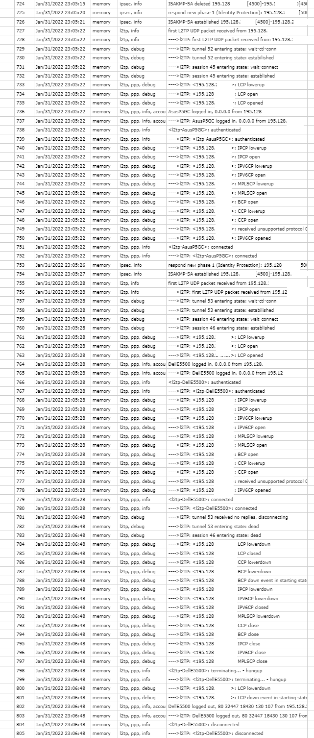

Hi, my routerOS is 7.1.1. I use L2TP VPN and it randomly disconnects.
I have attached a photo from the logs.
if you guys need additional information please let me know

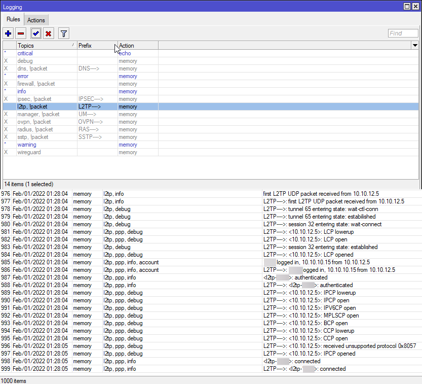

If that’s not the case, then you should create a new log entry, with topics l2tp and debug so that we can see more specifically what is happening…
Hi, How do i create new log and debug?
/system logging
add disabled=yes prefix=---->l2TP topics=l2tp,!packe
Okay done what now?
I disabled the rule cuz it may use resources if you want to use it first enable it then connect to your L2TP and after that collect your log and publish it. remove any public IP/sensitive data from the log
ik i am dumb how do i get thoose logs?
just like the screenshot you attached.
this is not it.
it should start with the —>L2TP
Sorry but that log is not after the new log entry…
what do you mean? you should try a new connection if I understand you correctly.
I only have that in logs ;p
Did you enable the new log?
Yes i did
Why don’t you use debug on the Topic ?
