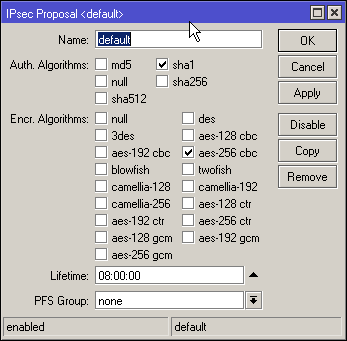

I am trying to create a L2TP VPN for an iphone to connect back, and I am getting this error:
Here is how the proposals are setup:
Anyone know how to fix this?
Yes, that’s how mine’s configured.
https://wiki.mikrotik.com/wiki/Manual:IP/IPsec#Apple_iOS_.28iPhone.2FiPad.29_Client
But enable ipsec debug logs to see exact proposal sent by the client.
Ok. I have set this profile exactly as described:
But, the log is now showing this:
Check and aes-128-cbc
Same, still error.

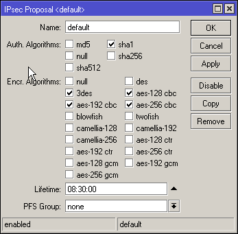

Any update on this? Here is what I have for proposal. Nothing seems to work.

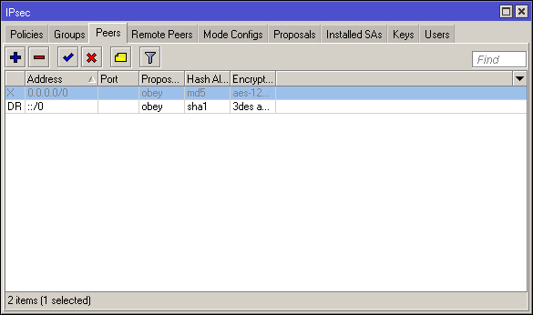

As expected… if you now use ****
/ip ipsec peer print
, you should see two peers with
address=0.0.0.0/0
, one created manually using
/ip ipsec peer add address=0.0.0.0/0 dh-group=modp1024 dpd-interval=disable-dpd enc-algorithm=\
    aes-256,aes-192,aes-128 exchange-mode=main-l2tp generate-policy=\
    port-override hash-algorithm=md5 send-initial-contact=no
and the other one created dynamically by checking “use IPsec” in L2TP configuration. If so, the incoming request from iPhone is first caught by the manually created one, and the auto-generated policy is then used, which is incompatible with the one used at the iPhone side.
So if ****
really shows two peers, please disable the manually configured one and try to connect the iPhone again.
I think we are really close here, but the same issue. I did indeed find the 2 peers, but I disabled one:
However, the same error as before appears.
These are not same peers. The first one is IPv4, the second one is IPv6.
