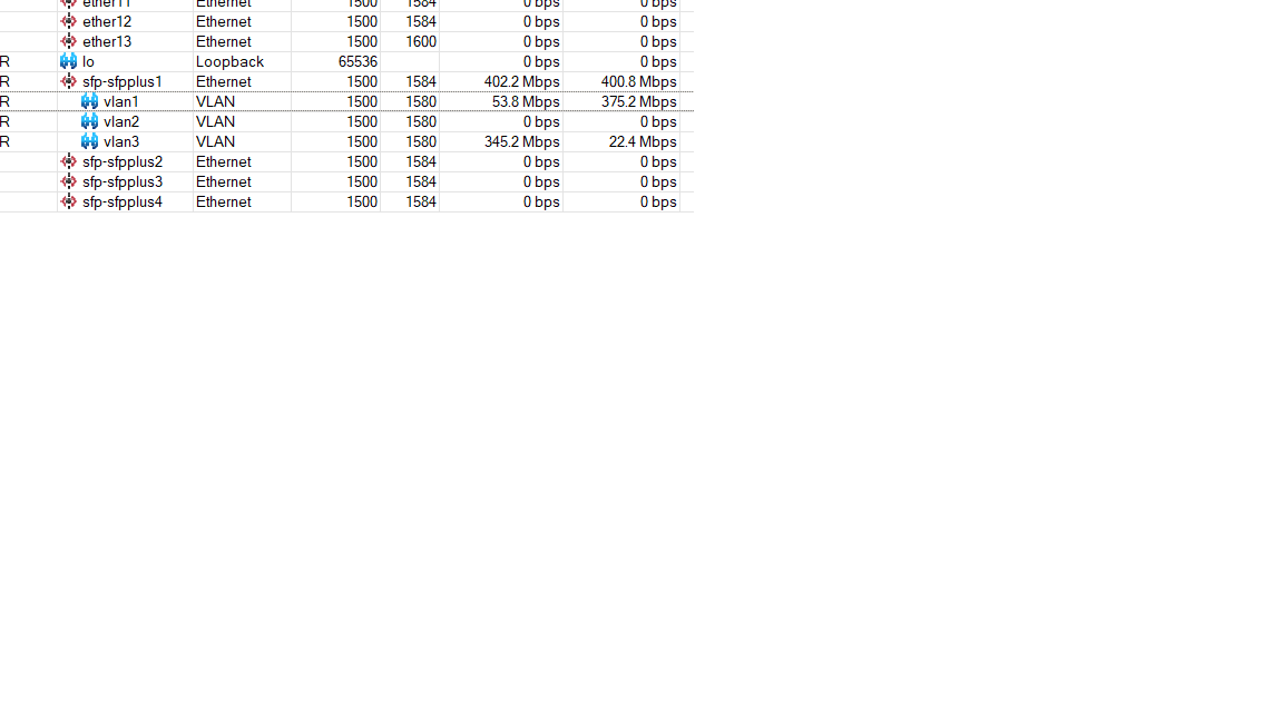

I can connect to other MT routers with that verion, but NOT to CCR2116 with VLAN interfaces(see attached screenschot).
VLAN1- is WAN, VLAN3- LAN. CCR2116 is connected to CRS305 with SFF interfaces.

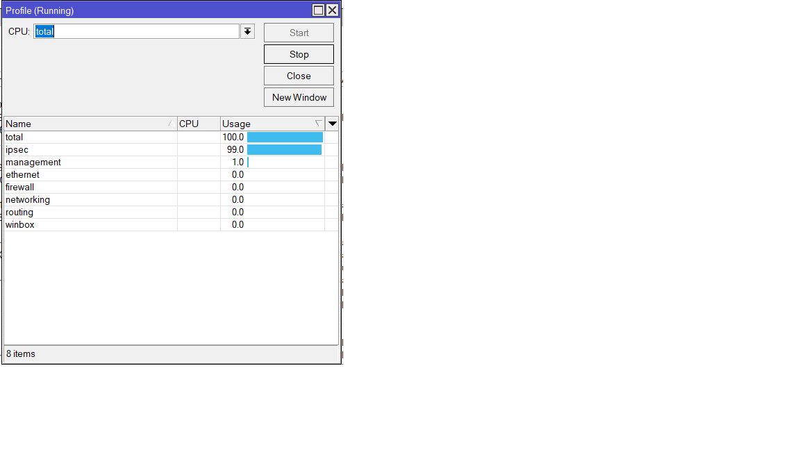

At another machine (x86) with ROS 7.17rc6 - there is non-stop 100% CPU (see screenschot) - when there is no VPN or any other IPSEC connetion to that router!!!
Does anyone has problem with VPN’s on taht ROS version?
