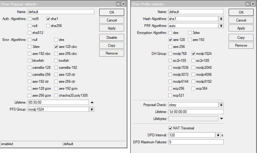

My guess is that system updates for any OS disable old \ weak ciphers for IPSEC.
I would suggest you to find out all the types of hardware acceleration for ipsec with the table:
https://wiki.mikrotik.com/wiki/Manual:IP/IPsec
Then you should enable all these types :
  1. IP-IPSEC - Proposals - default proposal
  2. IP-IPSEC - Profiles - default profile . Here also enable MODP size 1024 and 2048 or just enable all up to 2048.
If you enable some extra types, not hardware accelerated, there will be slow speeds and high cpu usage.
My example: RB760iGS (hEX S)
So hardware accelerated :
-DES and 3DES (MD5 SHA1 SHA256) - but these are too old and weak
-AES-CBC (MD5 SHA1 SHA256)
So my settings:
If I enable MODP 2048 instead of 1024 - works fine , but a higher cpu usage.
Even hardware accelerated my speeds = approx 60% cpu usage when 90 mbit
