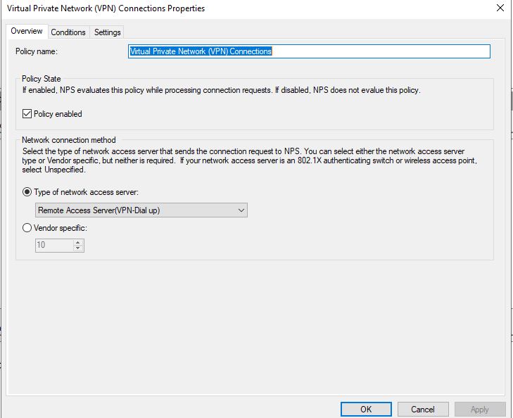

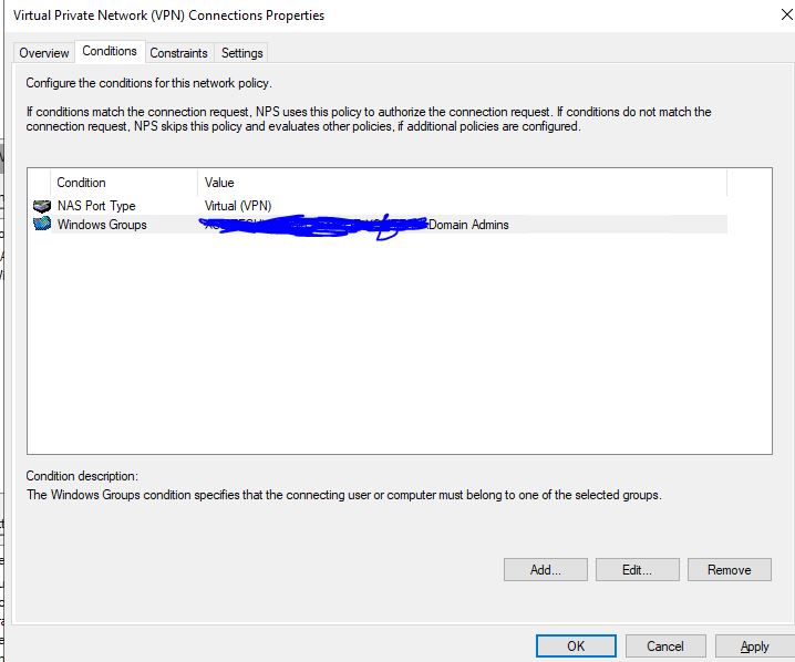

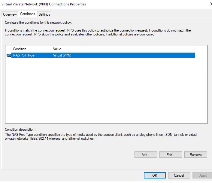

In Event is written : ID 49 The connection request did not match a configured connection request policy, so the connection request was denied by Network Policy Server.
On Mikrotik I have Request and Reject in RADIUS setting
So, Mikrotik is connecting to NPS, but policies not match. The only suggestion is, check all settings thoroughly step by step on both sides, especially on NPS. Or start from scratch.

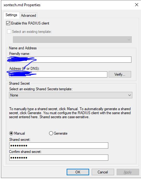

I Tried to do 10 time from scratch and nothing done. On Radius Client Setting Address IP should be the router IP and not from AD correct ?

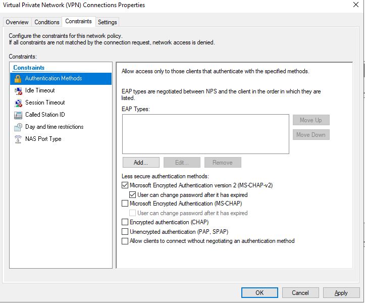

On the Conditions → Authentication Methods select “Unencrypted Authentication (PAP/SPAP)” and “Encrypted Authentication (CHAP)” and retest. I have Windows Server 2016 working with Mikrotik Dot1X using RADIUS with PAP and it works well.
Yes I know it’s unencrypted but I’m doing MAC Address authentication on an internal network.
Not helped
You can only do PAP or MSCHAPv2 against AD, there is no way CHAP can work.

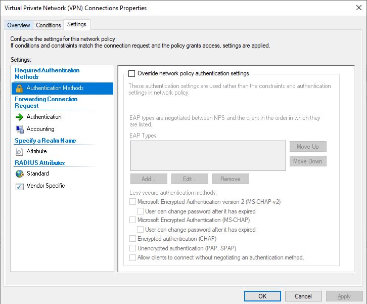

The ‘Ignore user dial-in account properties’ box is not ticked in your screenshots. I’m not a Windows expert, but without this I expect you have to apply a policy to the user accounts as the default is not to permit dial-in.
I tried with and without this box and nothing helped

Sorry, no idea. On Mikrotik my only error was incorrect src-address in radius settings, there should be router’s IP address.
