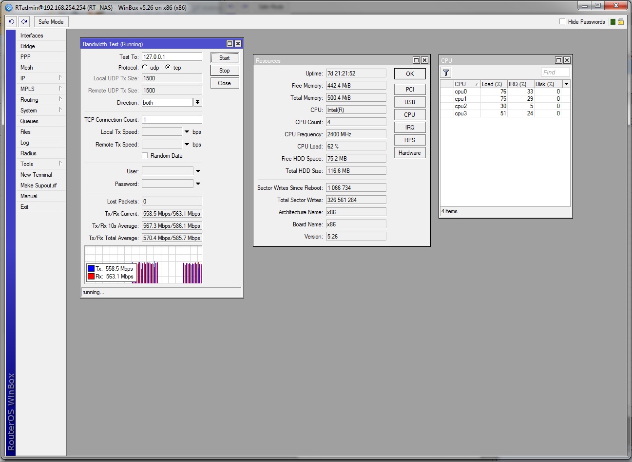

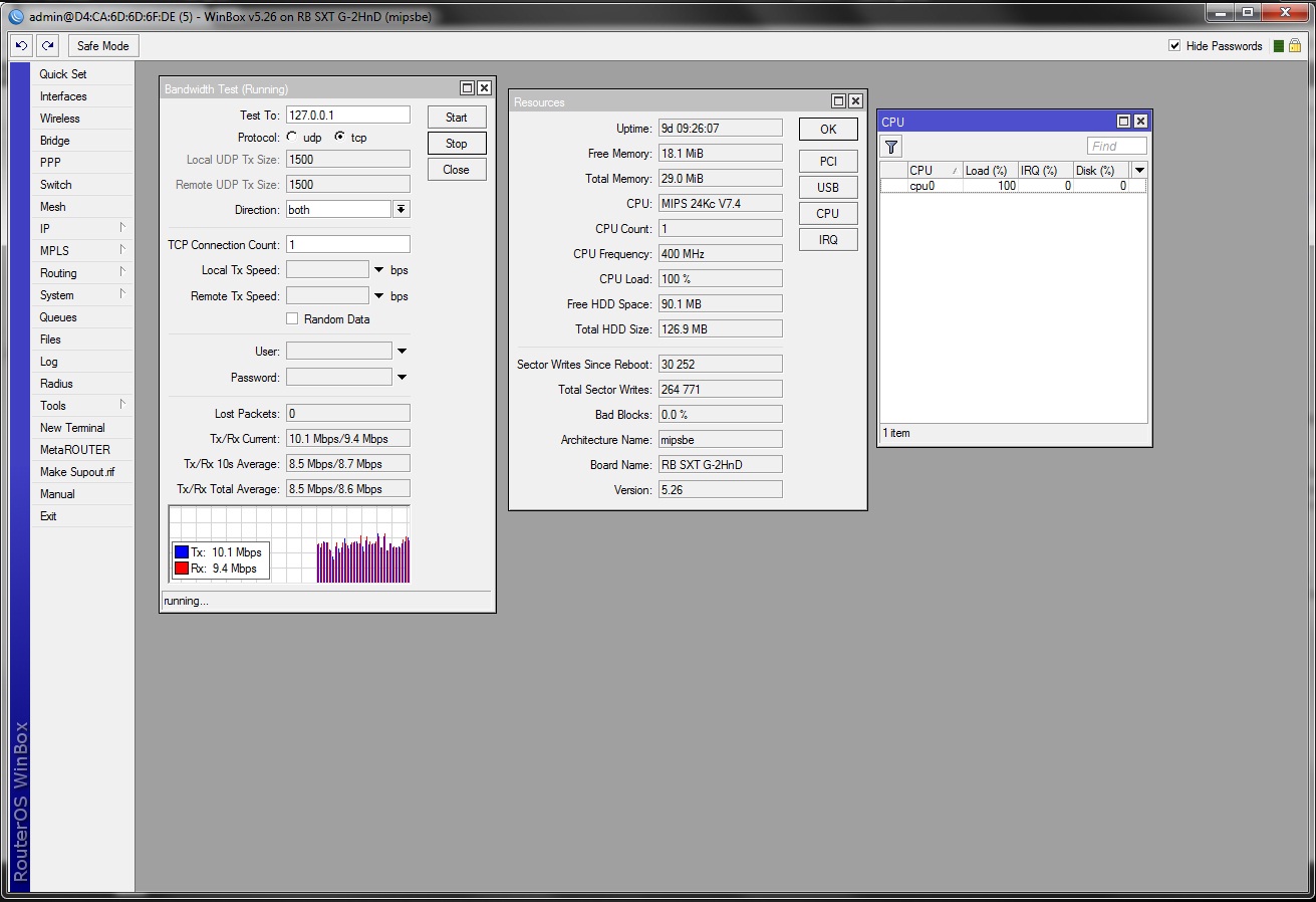

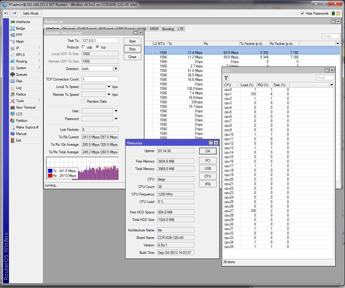

I saw that cpu usage on CCR1036 … not more that 5% ? may be this 5% equals to 100% ??.. and i tested this. look at attached files
Quad core Intel 2.4Ghz 8Mb cache with DDR2 512Mb ram VS 36 core 1.2Ghz 4Gb DDR3 ram VS SXT with 400Mhz
And if 400Mhz mipsbe gives 20Mbit of tcp, then 36 core with 1200Mhz must give 1200/400 * 36 *20Mbit = 108 * 20Mbit = 2160Mbit ?
