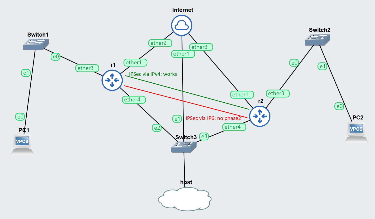

In a GNS3 lab, I try to establish an IPSec-tunnel over IPv6. Both routers are connected through a bridge (on a 3rd RouterOS VM). At first I configured an IPSec-tunnel over IPv4 and that worked. Then I tried to switch the tunnel to IPv6 but I can’t see any traffic on the connected interfaces and in the RouterOS log it looks as if the routers not even try to start the tunnel … likely a configuration issue?
