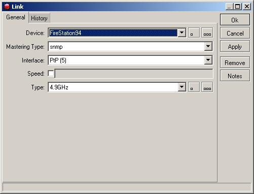

Some of my links are showing it, but not all of them. I’m using a fair share of Tranzeo stuff still, and I don’t expect it to show up on those, but the Mikrotik unit’s I have, I would like it to. Here’s a link that show’s it like I think it should be, as well as one that doesn’t show all of the info.

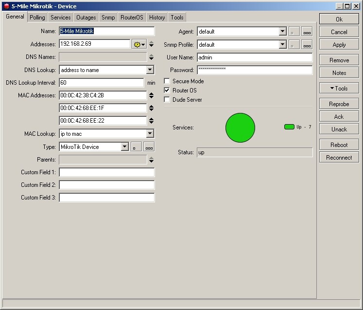

Any ideas, folks? I’ve tried makeing sure the User/pass is all correct, I’m using “default” snmp, as well as i’ve tired v1 and v2. I’ve also tried removing them and re-adding them. I’ve also tried ROUTEROS vs. SNMP for Mastering type, as well as trying different Link Types. Nothing seems to work.

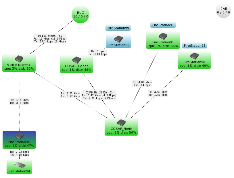

Here is one of my whole submaps. as you can see this one has two of the links showing the correct info, and the rest not. I can re-create any of them, and they will reappear just as they show here. That’s why it’s so weird. The ones showing right, will reappear right; the ones not, will reappear not.
My map is built with the top layer having all submaps, then links are all one layer deep. Not sure if that would make any difference. Some of the submaps then have links to other submaps, but always links to existsing ones, so nothing ever goes deeper that layer 2.

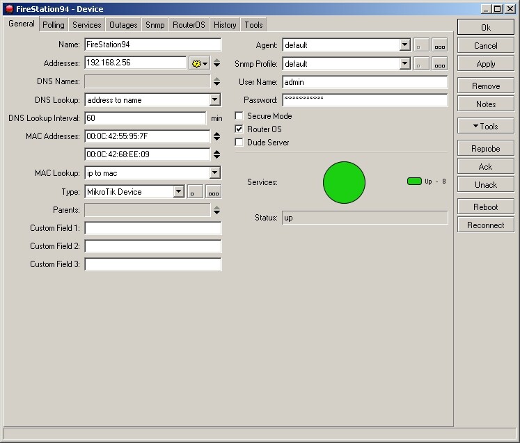

Just in case it helps, here is a couple more pics of the setup. This is one without the correct info.
