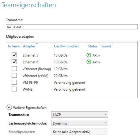

On my Windows Server i have created a new NIC Teaming with LACP and Dynamic mode, connection is 2x10G with DAC Cable.

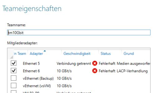

The link comes up and works fine but when i disable one link or remove the cable LACP not work and Windows shows me a LACP Link error. I have tested with Passive, active and static in SwOS.

Windows Teaming is set to “LACP” and “Dynamic”
I also tried the “Address Hash” mode.
When I remove a cable from teaming, Windows shows me a LACP error. Only when both connections are available again does teaming build up again.
