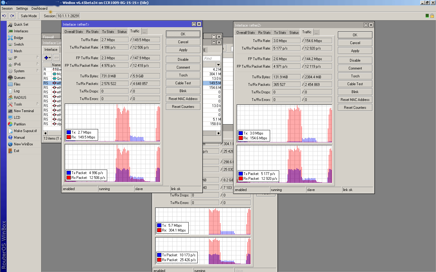

So my config is that im using Ether1 and Ether2, in a bonded 803.2AD group. I have played with all the hashes and for the speedtest.net that I am using for testing ( or iperf public servers ) the layer 3/4 seems to have the best results for hashing. I test out the same speed using any test method, 275-280Mbps and my ether1 and ether2 interfaces show 140/140 Mbps..

This is from a Speedtest.net test.. You can see its spreading out the load for download and upload nicely across both ports. But they only reach 150/150.
My CPU only shows a 1-2% increase during these tests.
If I unplug either cable the speed test will reach 980Mbps.
