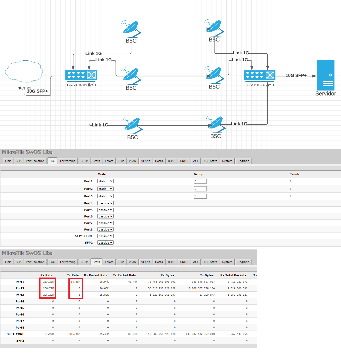

I have the following problem
I have three wireless links
at each end I have swos and I use lag to be able to add the links
the problem is that only one interface receives and transmits and the other two only transmits
I attach an image of the LAG configuration and the network diagram between my provider and my Core, which is a CCR2116

Likely working as designed, see https://help.mikrotik.com/docs/display/ROS/Layer2+misconfiguration#Layer2misconfiguration-Problem.2 . You cannot change the transmit hash policy in SwOS, from the manual CSS610 “load balancing based only on Layer2 hashing” and CRS318 “load balancing based on Layer2, Layer3 and Layer4”.

Replacing the CSS device with one which supports other hashing methods may help - it depends on the source and destination MAC, IP, TCP/UDP ports of the traffic in question, and how they vary for the traffic streams.
