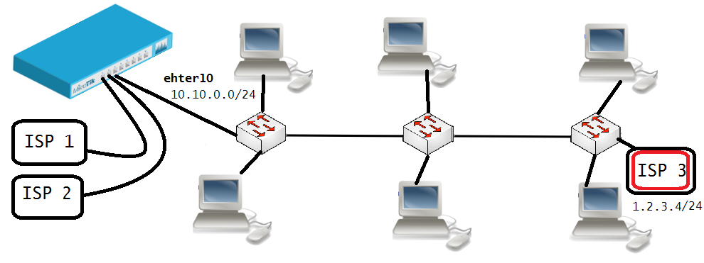

I want to access ISP3 on same time Ether10 having LAN//
What kind of device it he right-most LAN infrastructure device (the one that connects to ISP 3 cloud), a switch or router?
The most clean way of doing it would be to have all LAN infrastructure to convert ot full VLAN … so any link between LAN infrastructure devices (trunk ports) would carry only VLAN tagged traffic. The rest of ports on LAN devices would become access ports for appropriate VLANs.
One of ports on right-most LAN infrastructure device would be access port for ISP3-VLAN … the rest of LAN infrastructure would just pass ISP3-VALN between their trunk ports. Your router would then use ISP3-VLAN as yet another WAN interface (the same way it’s using e.g. ether1 for ISP1 and sfp1 for ISP2) and LAN-VLAN as LAN interface.
Which means, that any LAN infrastructure devices between the right-most and main router have to be VLAN capable (smart switches or routers).
If you’d like to avoid converting whole stuff to VLAN-based infrastructure, you’ll have to convert inter-connection ports to “hybrid” ports which carry untagged and tagged traffic.
The rest of config is the same as in full-VLAN scenario: you’d use ISP3-VLAN as WAN and untagged (on that particular router port) as LAN.
In this scenario switches between right-most device and main router could be non-VLAN ones (i.e. dumb switches), but I strongly advise against it.
Yet another possibility is that there’s actually a router at the right end of your LAN, which takes care of firewalling and routing towards ISP3. In this case it is just the matter of proper routing on main router.
As long as those square boxes with red arrows (assuming switches) are managed switches this should be doable.
