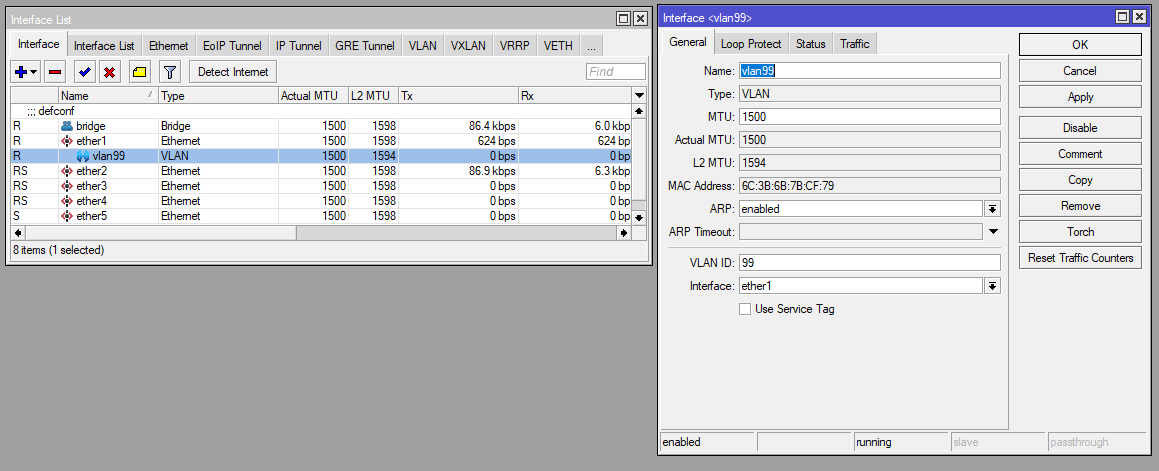

So VLAN is under the eth1 so this port is WAN
VLAN filtering is set to the LAN bridge
It is not just this. You have added a vlan interface to ether1, but you haven’t made ether1 a member port of the switch, which suggests you either haven’t read the article on VLANs I’ve suggested or you haven’t understood it.
If you post the export of configrations of both your routers (open a [Terminal] window and see my automatic signature for a hint) and I’ll give you some script commands to apply on both routers.
